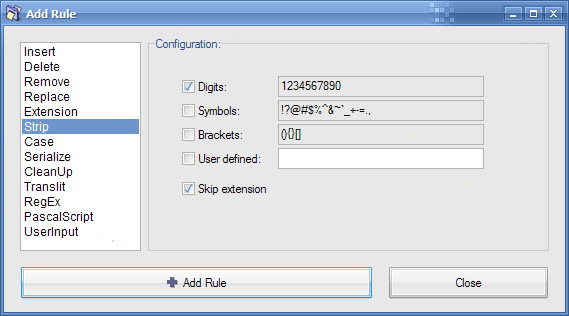

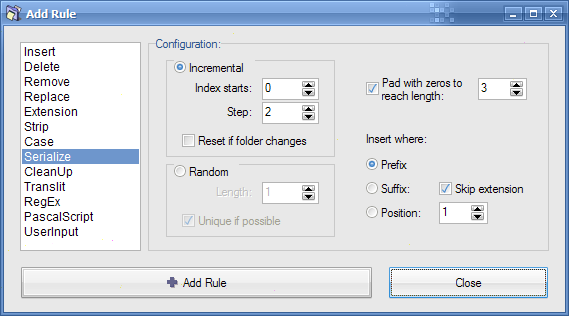

ReNamer can do it without using PascalScript:
You might want to strip the numbers first, though:
If you want to make it even more simpler, i.e. without using ReNamer or any other additional program (it's even easier with xplorer² mass rename), beats me.

« Reply #2 on: September 01, 2011, 12:24 PM »
Thanks!  The initial stripping seems to help quite a bit :)
