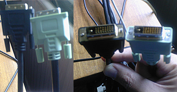

Well, that's the thing, I wasn't awake enough to spot the original item description only stating 1920 x 1200, but I did make sure it said dual link - this is the item's title on ebay "3M DVI-D Male to DVI-D 25 Pin Dual Link Gold Cable Lead".
I did wonder if I was missing something obvious so I did check if there was any physical difference between the the two cables and they both look identical in connection socket terms. I've just taken a (bad) photo to show that the black plug cable looks like a normal dual link - I've several single link cables which do look different (less pins, just as wikipedia mentions).
Note the number of pins are the same, width of "flat" pin is the same (these can be different depending on spec of cable). Only difference I see is that the green socket cable (the 2m working cable) has a slightly thicker cable than the 3m black socket cable.
