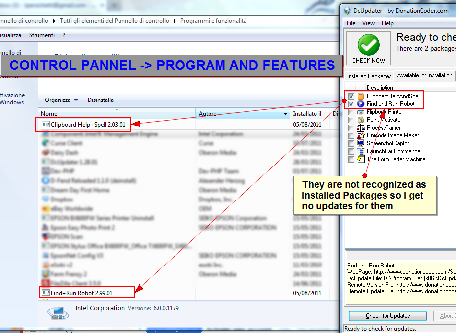

As the subject says, some apps installed does not seems to be recognized correctly by DCUpdater this imply that it is not able to propose updates if they are aviable.
I have problems with FARR and CHS, while UrlSnooper and DCUpdater works correctly
[attach=#1]

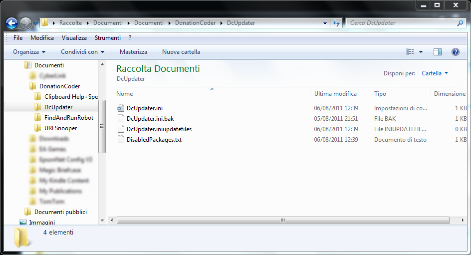

In my Documents/DonationCoder/DcUpdate folder there is no *.dcupdaterdirect file neither for working programs (UrlSnooper and DcUpdater) nor for not working ones (FARR and CHS).
Here is how it looks:
