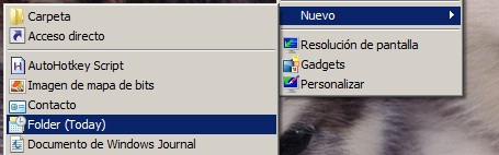

scancode
  • I will eat Cody someday.
  • Posts: 641
Re: IDEA: Make folder with current date
« Reply #2 on: August 02, 2011, 05:59 AM »
Folder (Today)
creates a folder with the current date as name
What's new in v1.0?
    • App is born.
Have fun!
Download Install FolderToday.exe (183.2 KB)
(VB6 runtimes required on Windows 9x/NT/2000)
magician62
  • Posts: 180
« Reply #3 on: August 02, 2011, 07:13 AM »
Thank you both for the replies. I have installed scancode's solution, and it works perfect for my needs.  :Thmbsup:

Folder (Today)
What's new in v1.0?
    • App is born.
Have fun!
Download  (see attachment in previous post)
Hi Scancode    Have installed your app   but i am getting no item installed on the right click context menu
Am running Win XP SP3
Any suggestions
Often the most convincing people are those who have lost the plot so much they don't recognize the difference between fact and fantasy
    • Superboy Coder
Re: DONE: Make folder with current date
« Reply #6 on: August 07, 2011, 12:13 AM »
Any suggestions
This application doesn't put an entry in the standard context menu you see when you right click files or folders.  This puts an entry in the "New" menu that you see when you right-click a blank area in a Windows Explorer window.  Does that help clear things up?

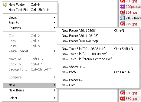

So XMD is bookmarked for reference. For now I have enough with XYplorer's New Templates:
