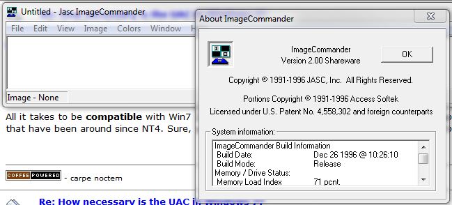

Why settle for just one OS when you can have several? That would allow you to set up virtually any host environment you want to test any software that catches your fancy. And without running the risk of screwing up your machine.
+111  :D
@f0dder - I saw that one coming (hehe). Here's one of my favorite examples Jasc Image Commander written in 1996, running perfectly on Windows 7, without using any compatibility mode support.
