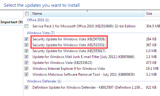

There's slightly more to the updates, as can be seen from the screenshot of what Vista thinks I should install.  E.g., IE 9.  I'm somewhat surprised by the update system, as I've already hidden a security update for PowerPoint 2007, that Vista had failed repeatedly to install.  That's probably because I don't have 2007 (that I know of...) as I have Office 2010.  Yet, Vista doesn't automatically mark SP1 for Office 2010.
I've marked the two updates that I think gave me problems.  Suppose I ought to look for any reports from anyone else...

I haven't been able to find out anything about the second one you list, but the first one, KB2507938, has been on Windows Secrets' Install list since mid-July.  Hope that helps.

kb 2507938 = Vulnerabilities in Windows CSRSS could allow elevation of privilege
http://support.microsoft.com/kb/2507938
kb 2532531 = Description of the update for Bluetooth Stack for Windows 7 and Windows Vista Service Pack 2
http://support.microsoft.com/kb/2532531
Known issues with this security update
Affected Windows Vista SP1 systems that are upgraded to Windows Vista SP2
Consider the following scenario. You are running a system that was upgraded from Windows Vista Service Pack 1 to Windows Vista Service Pack 2. Whether or not the system has update 942567 installed, the system will have support for Bluetooth 2.1 technology and is affected by this vulnerability. Therefore, you must install this security update.
For more information about update 942567, click the following article number to view the article in the Microsoft Knowledge Base:
942567  Description of the Windows Vista Feature Pack for Wireless
BTW, others are also having problems with kb 2532531:
Cannot install updates (KB2529073 &) KB 2532531 for Windows 7 - Microsoft Answers
