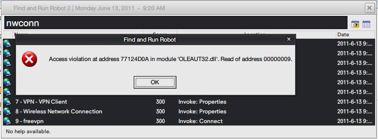

I'm a newbie at using farr.until now i find that when the farrsubscript plugin is enabled these plugins such as everything plugin ,loacate32 plugin and network connection plugin couldn't work correctly(see the picture as showed below).but when I disable farrsubscript,these plugins work fine.so i wanna know how to fix this problem.it seems that no one encounters such a problem except me because no problem like this was ever mentioned here. :(

hi palesaint.
actually this is a longstanding known problem.. i apologize for the inconvenience.  there is a bug in some of the older fsubscript dlls i think that interact with other plugins.
we REALLY need to identify which plugin release is at fault for this and make a serious effort to block it so this stops happening to people.

« Reply #2 on: June 14, 2011, 03:00 AM »
Thank u very much for ur reply,mouser!Maybe I have found the culprit that was Fscript.dll existing in the czb_pack http://www.donationcoder.com/forum/index.php?topic=17153.0 and if I replce this one with older or newer version of Fscript,this promplem won't happen again.maybe someone who encoumters the problem like me could try this.

« Reply #3 on: June 14, 2011, 03:13 AM »
Thanks for the report -- we have actually begun a process to identify these old version incompatibilities and this helps.  Hopefully it will be sorted out soon.
