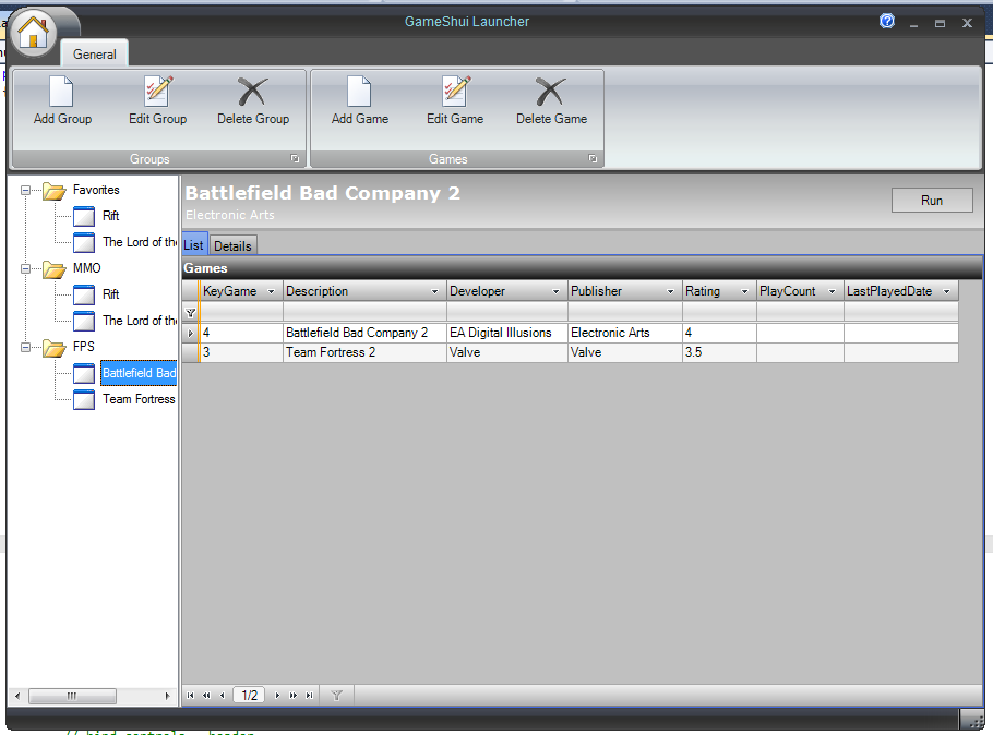

Just really wanted to show how far I was along, and see if it was beginning to look like what was being put forth before.  Know that this will be sort of a slow process between work and home... so it could be a while before it's totally finished... though I hope to have the basic functionality in place to allow it to be at least used in the next couple of months.
Figure 1: Main List View

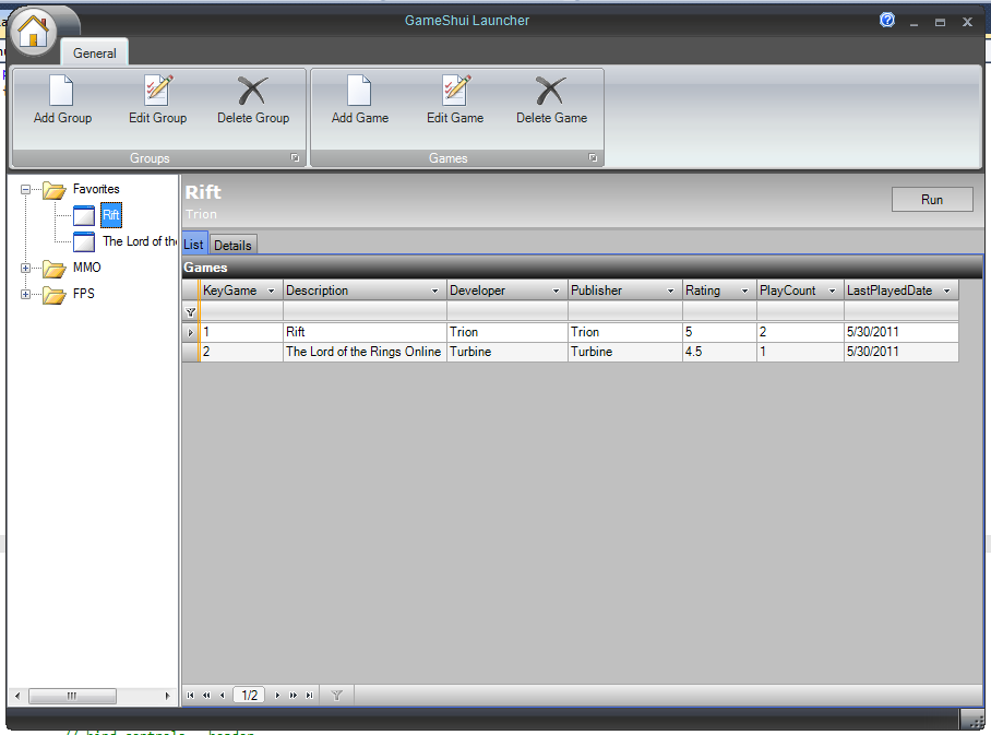

Figure 2: Main List View - Different Grouping
Again, the same view, but with the groups expanded.  Note that the header in the grid area always corresponds to the selected game (with the title and publisher), and the run button acts on that game.  I might put the ability to change the subtitle to a different column- I just thought of that, and it would be pretty simple, I think.  There's currently no way to save settings; that would be the first one for that, I suppose...

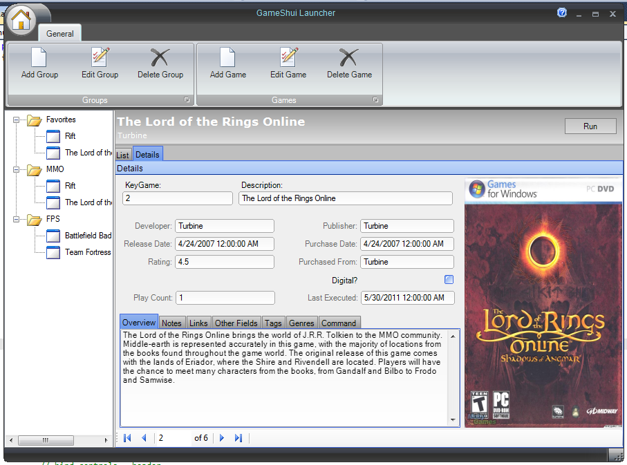

Figure 3: Main Detail View (Overview Tab)
This is the first view that is shown when the tabs are switched.  A few main fields are shown always, and the subfields/tables are shown in tabs below.  Note that though the main information is not editable from here currently, the sub tables have edit functionality planned currently.

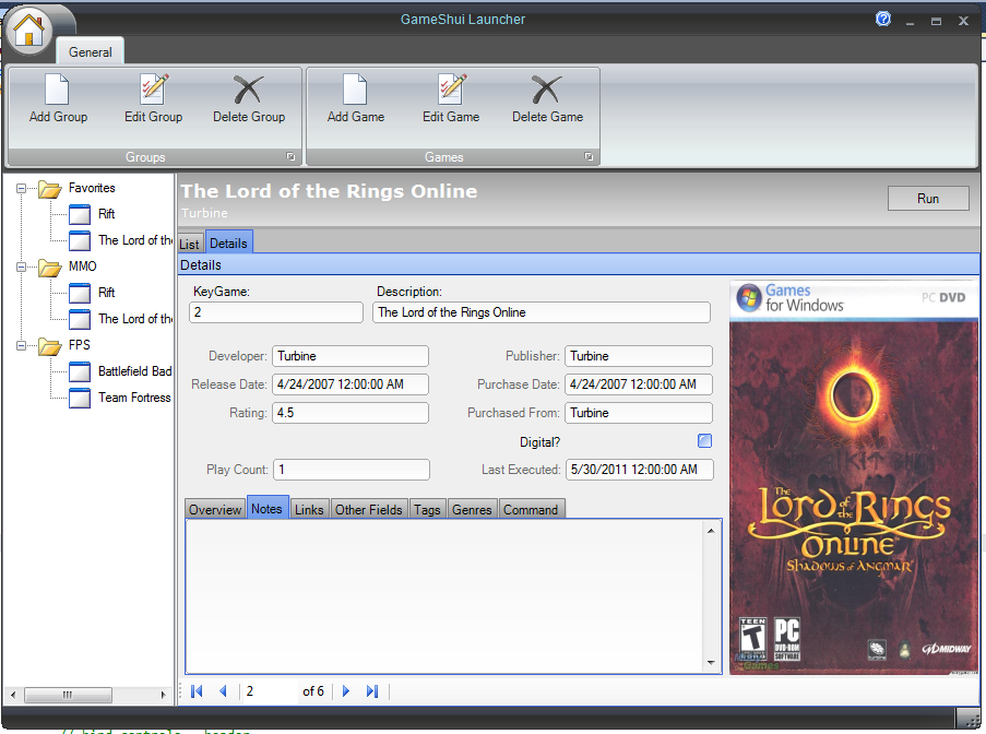

Figure 4: Main Detail View (Notes Tab)
Just as with the Overview tab, the Notes tab is a freeform field.  It is rich text, so I'm thinking about adding that functionality, though I haven't yet.

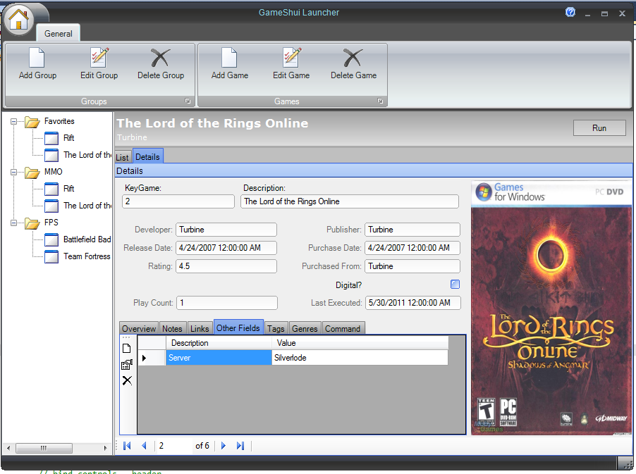

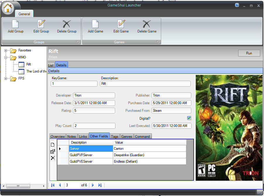

Figure 6: Main Detail View (Custom Fields Tab)
This is an area for any custom fields that are per game, stored as description and value.  They are free form, and not shared.  You could store the same information in the notes field, I suppose, but I thought this an area where certain things could be stored in a more organized fashion.

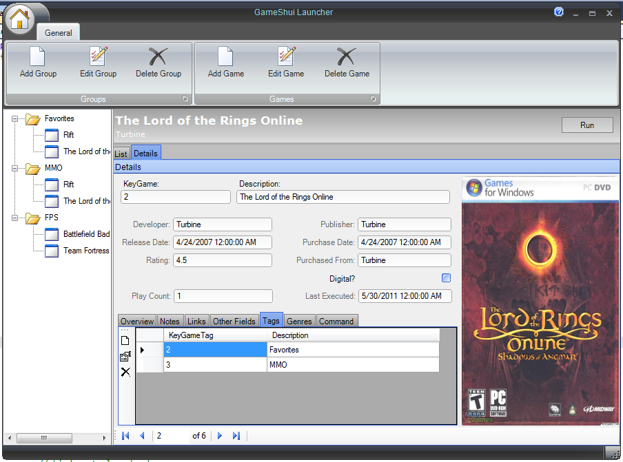

Figure 8: Main Detail View (Tags Tab)
Games can be tagged with whatever tags are defined; I hadn't planned on this interface, but ran into a couple of problems with the db.  This is subject to change if I can get the problems sorted.  I wanted more of a text field type interface with all of the tags, and a +/- beside them.

Figure 10: Main Detail View (Command Tab)
This is where the command is stored for running the game.  The test button will test for the validity of the command (as much as possible) without running the game.
