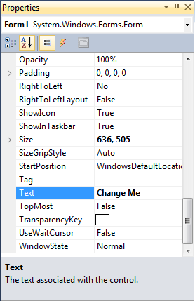

Firstly, lets deal with the easy part - Which is changing the name of your form.
To get the required property list up, you will need to click at the top of your form:
Now you need to look at the bottom right of your workspace and find the following screen. Change the text where I have typed "Change Me"

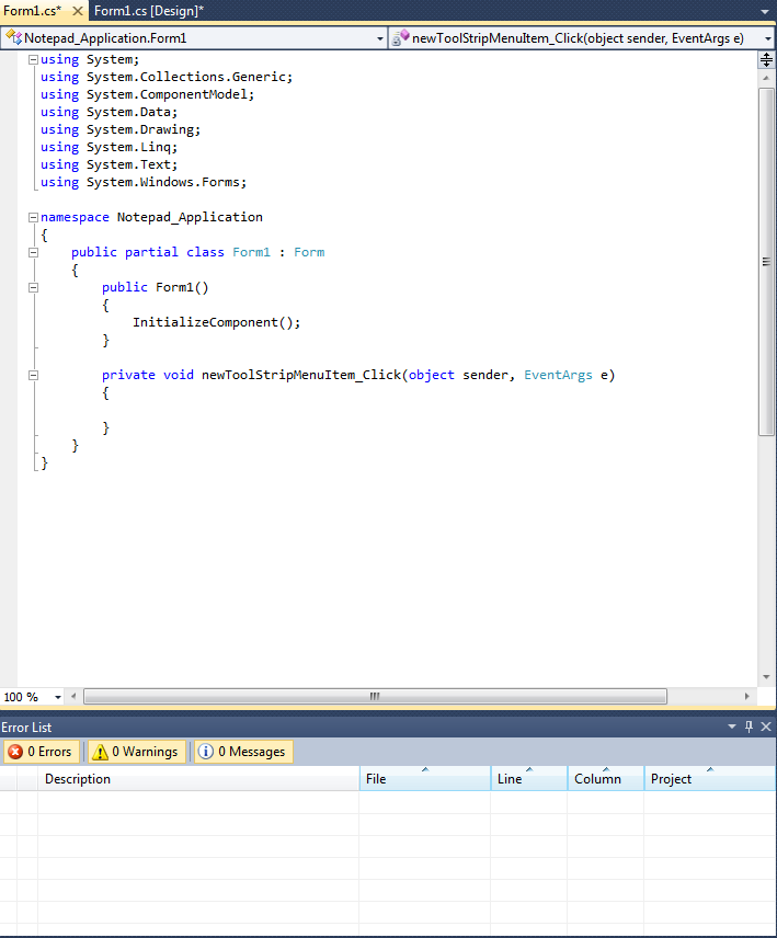

OK, now thats done, lets get some coding done!
What you now need to do is click "File" (On your form - not on Visual C#) and double click "New"
Wow, the screen changed and now theres confusing text everywhere!
Don't Panic and Take a Deep Breath!

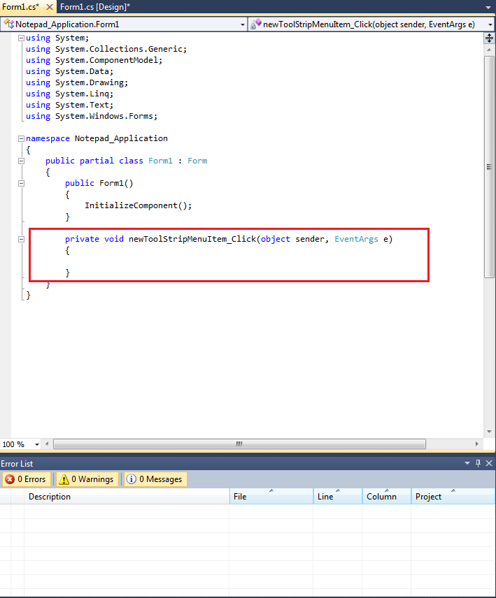

Your cursor should have been automatically placed where it needs to be:
Now you need to type the following code into the area your cursor is:
richTextBox1.Clear();
Which should now look like this:
