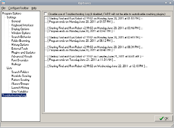

The file that gives me trouble with Dropbox is FarrTroubleshooting.log. It is always locked. Is there any way to not log whatever it is supposed to log?
ewemoa
  • Posts: 2,922
Re: FARR and Dropbox - conflicts...
« Reply #4 on: June 22, 2011, 03:08 AM »
IIRC, the bottom-most item in FARR's options dialog has to do with the troubleshooting log and it may have a checkbox relating to enabling/disabling logging.
May be that will be of some use.
Thank you!
« Reply #8 on: June 23, 2011, 01:24 AM »
ewemoa says:  IIRC, the bottom-most item in FARR's options dialog has to do with the troubleshooting log and it may have a checkbox relating to enabling/disabling logging.
ahhhh.. good find, i didn't even think about that.  that makes complete sense that it is giving dropbox trouble.. maybe i should make an option to close it when not needed, rather than keeping it open for thr whole session.  adding to my todo list.
