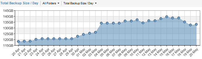

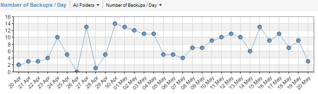

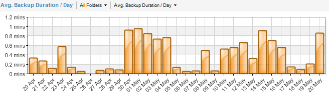

I think Oops Backup is very good and it seems quite fit for superboyac's plan. I've been using it for quite a while and it has saved me a few times. I set it to backup every 1 hour if there are any changes, and keep older versions for up to 3 months. My whole data is about 50GB and the total backup size is now about 150GB.
I'm showing some usage statistics below if that can help
[attachthumb=#1]
[attachthumb=#2]
[attachthumb=#3]

Oops Backup has some issues (mostly space and RAM issues). I don't know if they've been ironed out, but you can do a search for related threads.

You could still test it though. But test it in a realistic setup, with databases and other bigger files. This is where the problems started -- versions pile up and take a huge amount of hard drive space. And then it's not that intuitive to get rid of versions etc. Well, it wasn't... Don't know if it is now.
I'll just quote J-MAC from the other thread (I hope he doesn't mind...) :
Also it has difficulties - big difficulties - deleting old backups. My backup storage grew a little too big too fast for my liking so I wanted to reduce its size. If you delete the oldest backups from within Oops it slows to a crawl. E.g., deleting less than a week's worth of backups Oops took over 20 minutes just to select the old backups! Then a couple hours - running at 75 to 85% CPU trying to delete them. It was unresponsive for so long I finally gave up and killed the process - and the service, too - and then just went into DOpus and manually deleted the files and folders. Manually. Took all of < 1 minute.
Then last night I noticed that the Oops storage area had increased by an additional 145 GB! I found a folder named "Recovered Files" in the Oops Profile folder. Why? I don’t know yet. I deleted that too.
It just doesn’t act like most other backup programs I have used, and it doesn’t allow you to freely change, delete, pause, etc.; all features that Altaro really needs to implement in order to make it a usable product IMO. I'm awaiting the next reply from support to see what I do from here.
