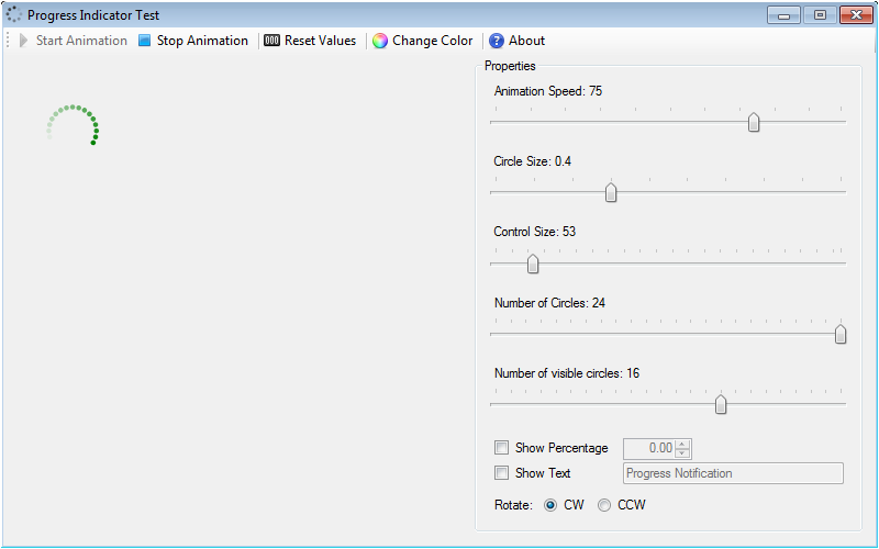

I think for the actual display, I'd like to use something like this:
http://www.codeproject.com/KB/progress/ProgressIndicator.aspx
Circles are perfect for indeterminate wait indicators.

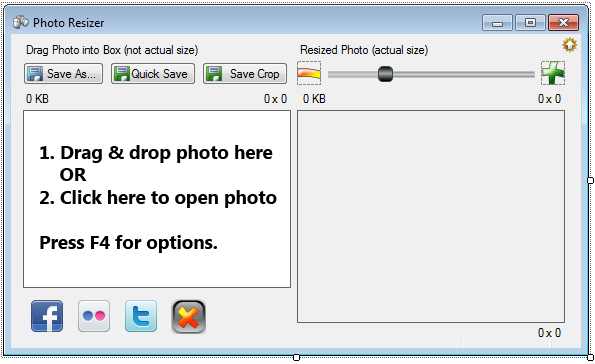

The UI is minimalistic (Super Simple Photo Resizer).
I've tried to avoid putting anything in there that I can avoid, e.g. no menu, no status bar. So the only option is to either create a new display element, e.g. a pop up window or panel as above, or go back and rethink how to put in a notification area that's unobtrusive, yet obvious enough when needed.
The event happens when clicking the SNS icons.

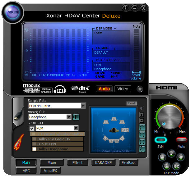

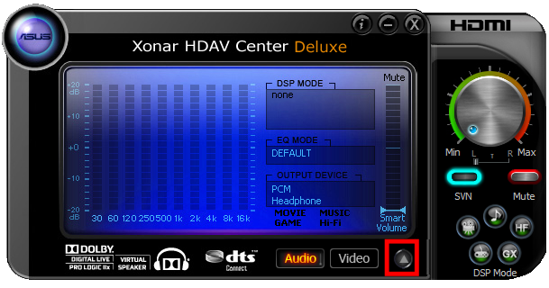

That's one of the problems that I want to address -- the standard Windows UI is simply difficult for a lot of people. (It's also pretty boring a lot of the time.)
One of the things that people are used to is surfing, and while it's kind of nutty to reproduce that, it shows that people can adapt to different UIs as long as there is a certain amount of standardization.
The problem with non-standard UIs in Windows Forms is that they go way too far with widgets that nobody has seen, or are very uncommon. e.g. The highlighted button here is for a menu (as per the mouse over):

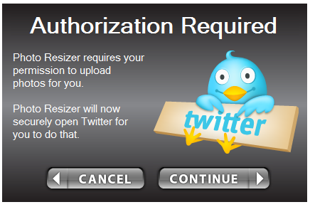

But, when you click it, you get this:
It slides up.
Not what you'd expect from a menu.
Now, it certainly looks nice, but there's still a lot there, and non-standard things get lost quickly.

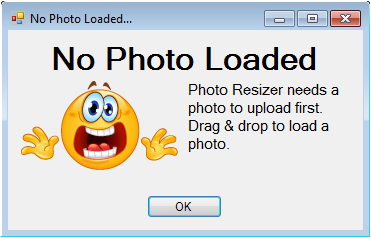

From the above shot of Photo Resizer, here're "standard" looks:
Both very boring.
Also, the title bar serves no purpose, and in the first one, it is only confusing with extra buttons that are not needed.

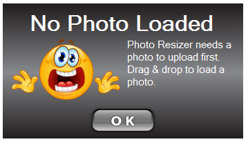

Back to the version I'm debating:
It's clear, looks better, and had less in it that can be confusing. There's 1 thing to do. Click OK. Not 2 or 3. Just 1.

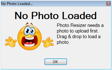

At the moment I have notifications with 2 options - continue or cancel. I'd kind of like to only have 1, but as I'm dealing with SNS accounts, I have to make sure that people can opt out at any point. It's their information after all.
But, if you look at the UI, there are no tricky or unusual components. The buttons are still buttons, and the text is still text. The form border is set to None, but that's the most extreme part. And the border isn't needed. (The form is still movable from any point on it - click and drag - which is actually easier than clicking the title bar.)
I know a lot of people here are DC are vehemently opposed to anything other than the run-of-the-mill form and opposed to any kind of design in a form. But I don't think the people at DC are representative of the market at large.
Anyways... I'm still debating things... Not sure myself...
