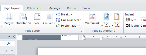

AndyM
  • Posts: 616
Re: multiple align inside the same line
« Reply #4 on: May 06, 2011, 01:14 AM »
Put a left tab stop in the ruler at the top, all the way to the left.
Put a right tab stop all the way to the right.
Put an actual tab character before the "one" and another before the "two".
The first will align the "one" to the left and the second will align the "two" to the right.
(second image shows formatting marks)
If you are doing multiple lines, when you hit the Return key to start a new line (paragraph), the tab stops will be created in the subsequent line (paragraph).
This is one way to do columns in Word, handy for short ones.
« Last Edit: May 06, 2011, 01:23 AM by AndyM »
