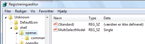

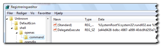

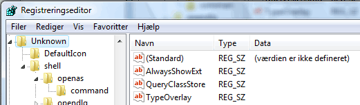

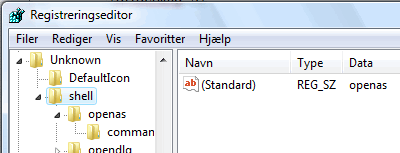

my Vista reads:
%SystemRoot%\system32\rundll32.exe %SystemRoot%\system32\shell32.dll,OpenAs_RunDLL %1
I would guess it is the same? So the problem may have been caused elsewhere? Hmm...
Info:
There is also key with the name DelegateExecute. Its' value data:
{e44e9428-bdbc-4987-a099-40dc8fd255e7}
However, the one above is named openas and does not have any data defined. My guess would be that this could be the problem. But of course I have no idea what it maybe should read.
HKEY_CLASSES_ROOT\Unknown\
?  :tellme:

NB! It should be noted that the registry keys (on the above shown screenshots) still are exactly as they were before the fix, because the address for the proper key was quite different:

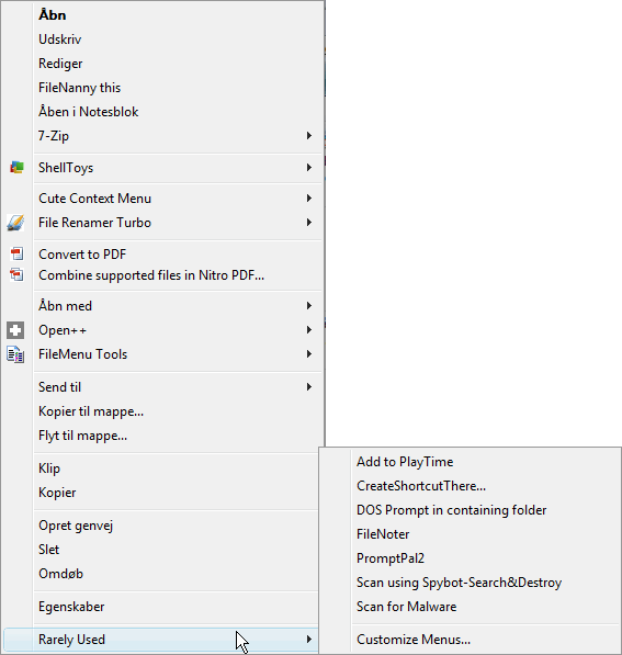

-yes, it is terrific, but maybe a little overwhelming, when looking at 296 items... :-[
I use CFi ShellToys, which include the pictured bottom line, "Rarely Used..."
This is for a text file:
This solution has turned out to be more trustworthy, because it doesn't alter or remove any keys, things are either 1) on display, 2) rarely used, or 3) hidden (edited: nothing is hidden in my setup).
