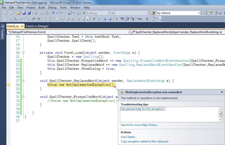

I'm using Paul Welter's Netspell for the first time, and have rigged up a test harness.  I've placed the needed DLL and dictionary files in the necessary /bin/ subfolder (I'm programming in C#, and will attach a zip of my test project):

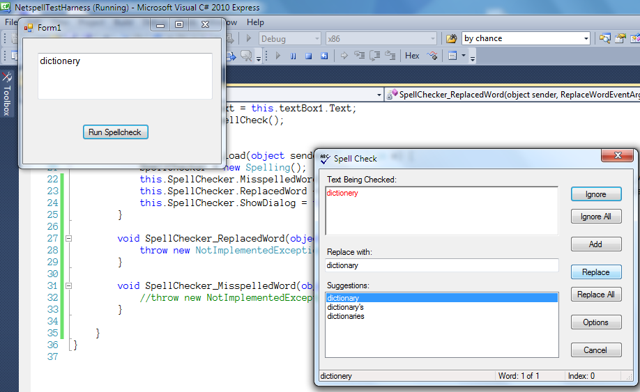

I've created a test harness C# WinForms application with a textbox and a command button that invokes the SpellChecker.  I enter a single intentionally misspelled word, "dictionery" (which should be "dictionary") into the textbox, and click the command button to invoke the spell checker.  The SpellChecker_MisspelledWord() method gets called, as it should, and NetSpell's internal "Suggested Words" form pops up.  I select the first suggested word, which happens to be the correct spelling, and click the "Replace" button.
Of course, I get a Not Implemented exception because I've not yet implemented the SpellChecker_ReplacedWord event.
I know there's a SpellChecker.ReplaceWord() method, but am not sure where/how to use it.
What I want to happen: when I select the correctly spelled word, "dictionary" (see second screenshot above), and click the Replace button, I want to programmatically replace my program's textbox's incorrectly spelled word "dictionery" with the replacement word.  Even more helpful that a post of corrective action would be a post of corrective action and an attached zip of my project modified so that it works.

I think I figured out what I want to do.  I'm attaching a screencast of it in action, along with the updated C# project (zipped).
