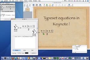

However, if you're not entirely turned off of Latex yet, and since your final layouts are being done on a Mac, may I suggest Latexit:
http://www.apple.com/downloads/macosx/math_science/latexit.html
(requires MacTex: http://www.tug.org/mactex/)
No bugging around with layouts, configurations, or documents; just work up your math snippet, export and paste.

This here says Latexit can export EPS:
http://pierre.chachatelier.fr/programmation/latexit_en.php
Besides, it's freeware, so it's practically painless to give it a shot.
Nice!  Thanks.  I don't know why I didn't catch that.

@SB- Latexit looks promising. EPS vector format is what we used for our formula "artwork."
@Edvard- very cool find. Thanks for sharing! :Thmbsup:
