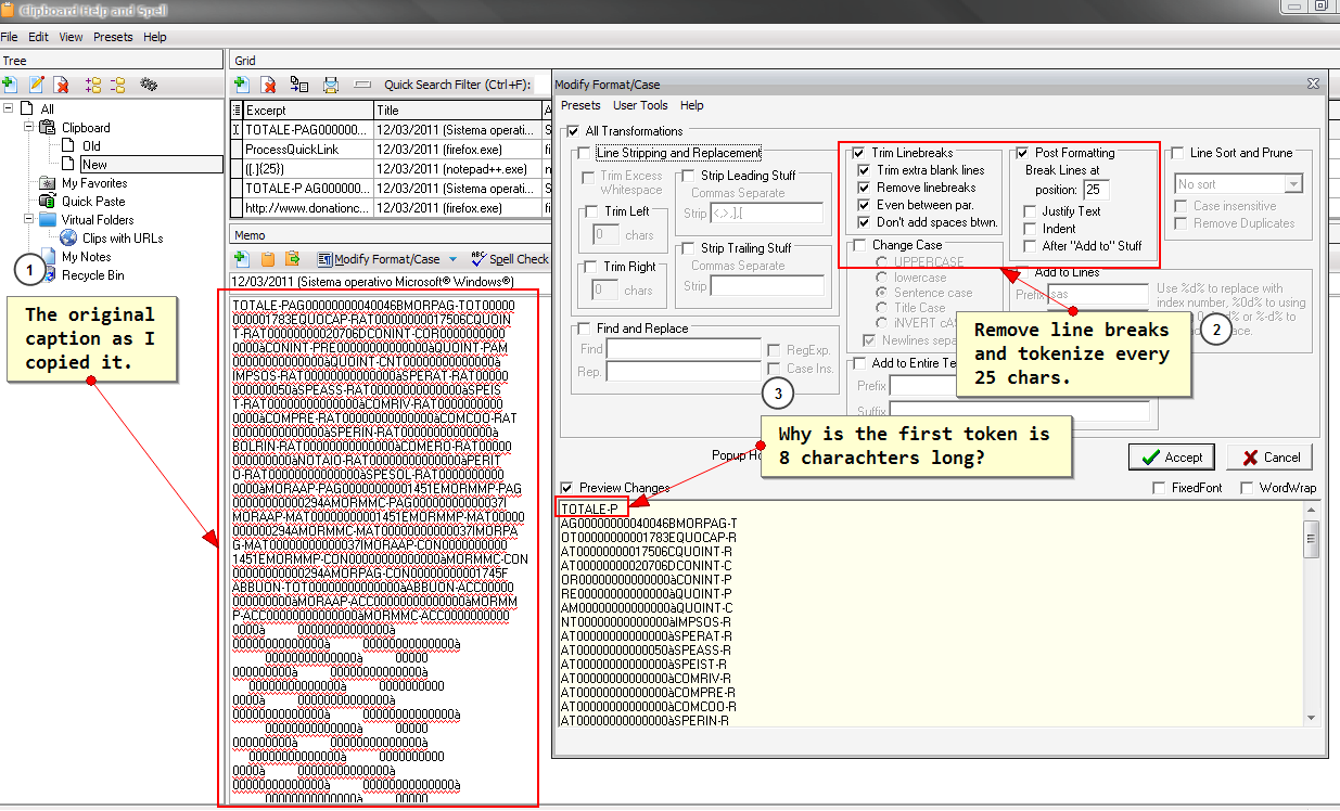

I think that the "Break lines at position" feature is a little buggy.
What I would like to do is to copy a text, remove all the new lines characters and then tokenize the copied text every 25 chars.
The problem is that when I set the "Break lines at position" to 25, no mater what, the first token is always long 8 chars and the succeeding tokens are screwed up. Here is a picture of what I mean:
If you need I can paste the original text to allow you to reproduce the behavior.

paste me the original text so i can use it to improve.
it's trying to split at word breaks, but even that is not being done very well is it..  what i will do is add an option to not try to break at wordbreaks and just hard wrap every X characters, and see if i can fix the bug that has it spitting your - separated words wrongly too (i think the long lines without spaces/punctuation are confusing it).
should be a very fast fix.

Wow, very fast reply!
The original Text (I use code tags to have a mono-spaced font):

Result I would like to obtain:

In case you wonder, this is not normal human readable text, but a COBOL crappy way of storing some particular information. :P
Re: Post Formatting options in Modify/Format Case
« Reply #3 on: March 12, 2011, 08:54 PM »
Try the latest download; note i havent told the updater about it so youll have to download manually or instruct updater to download even though it thinks it's not new.

Now it works perfectly! :)
Also the hotkey management is fixed. Thank you very much.
