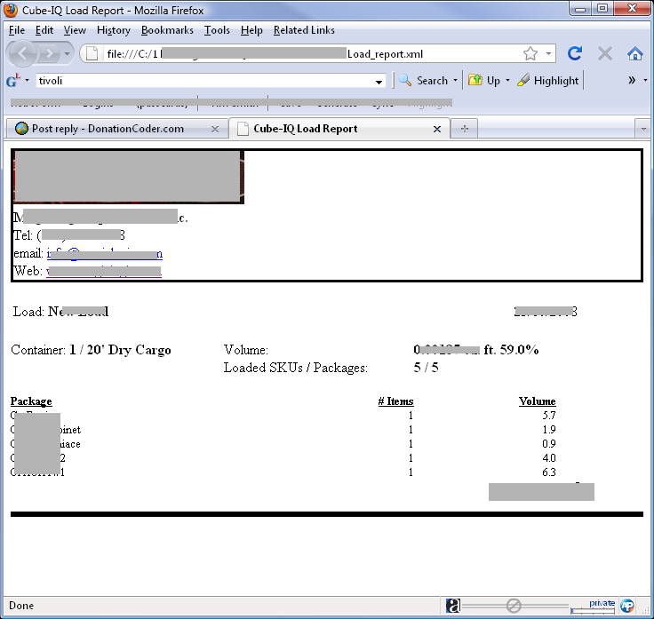

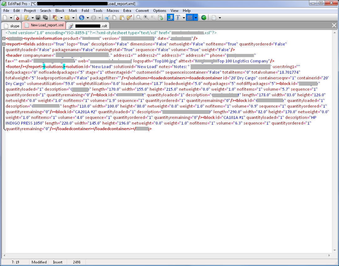

Ok well it's not very 'pretty' because this is a bit of a dry old manifest, but basically we go from this:
Input XML
through the stylesheet, to create this
At this point you have complete control over the layout, since the stylesheet is turning your XML into HTML. In otherwords, you're telling the stylesheet what to look for in the XML, and then how to present it using HTML commands.
So it appears nicely in your browser and from there you can print, save etc.
