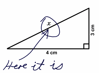

Unusual though it may be to find a post from me that is anything other than facetious, fallacious, or frumentarious, mathematical formulae are something of a speciality of mine. I think some of you gentlemen would benefit from an example in order to keep your wits sharp. So, here is a challenging little example…
Find x
worstje

« Reply #10 on: January 20, 2011, 06:37 PM »
That one is so simple and so standard I actually redid the math twice to make sure I wasn't getting it wrong (you implied something like challenging and that it is about sharp wits, and I'm afraid it ranks nowhere close to that for me. 8))
