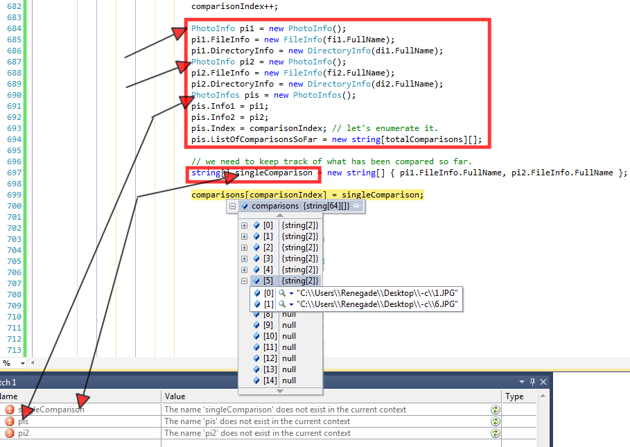

Sigh... Yes... I've searched... And I can't find the answer... This is bizarre. (I bet $10 somebody will find the answer real easy now...)
Anyways, check this screenshot:
My problem is that all of a sudden, I can't "mouse over" to find variable values when debugging.
You can see in there that "comparisons" has values in it, however, "singleComparison" shows "...does not exist in the current context." Huh? It's populating "comparisons", so it obviously has values in it, but...
Similarly, pi1, pi2 and pis won't show any values there. They don't exist~! But they do~!
See how bizarre this is?
Does anyone have any idea how to fix this?

When you are stepping through the code at line 690 are pi1 and pi2 available then?
Re: C# & Visual Studio Problem
« Reply #7 on: January 16, 2011, 12:35 AM »
No. That's the thing During the entire block there, they are not available. However, they have values...

It's just that section of code. Other sections (that I checked) seem fine.
So, I tried this...
I had that code arranged like this:
Code: (csharp)
if (false)
  // old stuff
else
  // all the code was here... (new stuff I'm testing)
// I moved it all here...
WTF? It's normal again...
Has anyone heard of this kind of wonkiness before?

Thanks for that. It seems that it is the exact same issue. The workaround is to define the local variables outside of the conditional.
« Reply #17 on: January 16, 2011, 06:47 AM »
what was the condition in the if statement?
false? :)
I didn't want to assume... :P  He could have just been doing pseudo code like the rest of the code :)
« Reply #18 on: January 16, 2011, 07:14 AM »
false? :)
Quite correct, and indeed, it is THE crucial point.
false? :)
Quite correct, and indeed, it's is THE crucial point.
"comparisonIndex" is an Int32 counter that I initialize outside the conditional to -1. It is only ever incremented, so the following will only ever evaluate to false:
Code: (csharp)
if (comparisonIndex < -111)
Stuff works then.
In short, in C++ or C# (and possibly all other .NET languages or in VS 2010 or something like that), you CANNOT use (literally, and not pseudo-coded-ly ;) ):
Code: (csharp)
if (false)
And then follow with an else clause.
Instead, use an expression that you KNOW will always evaluate to false.
Bizarre. Yes. Easy to get around once you know. Sure. Sane? Hell no~!
