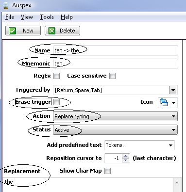

I just came across this, and think it sounds absolutely wonderful.  I am having a bit of difficulty seeing how to "make it start working."
For example, if I want it to ALWAYS replace "teh<space>" with "the<space>", exactly how do I do that?
Click the "New" button, and set up a Replacement as per this screenshot:

OK, I got the T E H thing to work (can't type t e h anymore as it gets replaced!) :).  Don't know what was happening, but it would not take any typing in the replacement box.  I did a paste into it instead, and that worked.  Later, I observed it WAS taking direct typing into the box.  I don't know exactly what the sequence of things was, but definitely, it did not take direct typing when first tried--and there was a beep on some of the keystrokes.
What does the check-box Erase Trigger on/off do?
It deletes (or does not delete!) the space/enter/tab that you typed to show Auspex that you'd come to the end of your word.
It's handy to have that character deleted if, for example, you are using auspex to replace short acronyms with something that you then add something ELSE onto.
For example, I have one called mld which exapands to http://downloads.ourwebsitesaddres.com/
so I can type mld<tab>readme.txt and auspex creates:
http://downloads.ourwebsitesaddres.com/readme.txt (having removed the tab char for me)

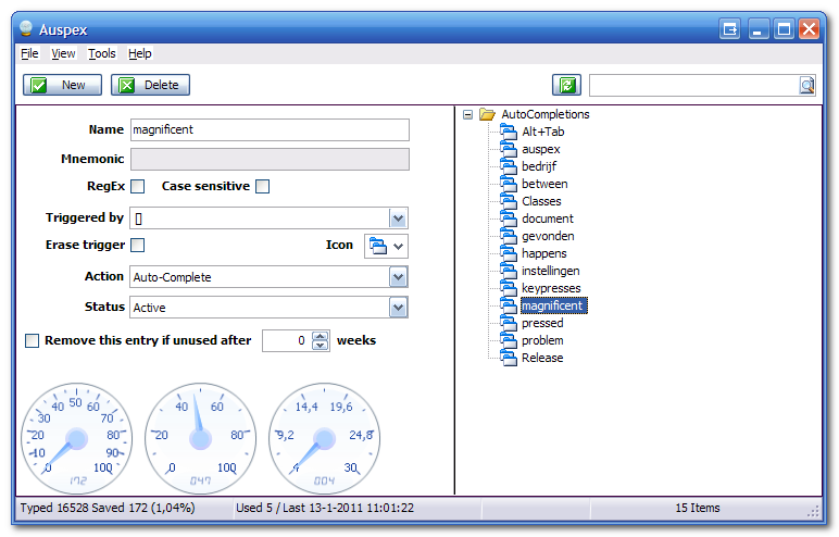

« Reply #16 on: January 13, 2011, 11:23 AM »
Hi! This is quite a promising piece of software, thanks for taking the time to build it! I've tried a lot of productivity tools, my current favorite is Autohotkey. However, it really seems Auspex has something unique in the way it dynamically recognizes often-used words (it works fine side-by-side with Autohotkey btw).
Some bugs I'd like to share:
[1.] Keypresses in quick succession seem to get mixed up (see attachments "1-1" until "1-4")
  - When editing code, I often want to insert a new line between two existing lines. Therefore, I position the cursor at the start of the line above which I want to insert the new line. Then I press Enter, quickly followed by Up. The problem is: if there is not enough delay (<±250ms.) between the two keypresses, Up gets sent first, followed by Enter. Result: the new line gets inserted at the wrong position.
  - A seemingly related problem arises when using Alt+Tab to switch applications (e.g. switching from Word to Notepad). Switching apps still works, but when I switch quickly (just a quick press on Alt+Tab and immediately releasing both keys), a Tab is sent to the switched-to application. Keeping Alt pressed for ±500ms. longer solves the problem.
(I've tried this with or without Autohotkey running, but the problem stays)
(maybe it's related, but when I examine the file Auspex.xml, I find that a lot of candidate sentences have spaces written at positions where I haven't typed them - either that or my typing is way worse than I think...; e.g. name="Thiss entence comesf rom thef ile auspex.xml")
[2.] Some Ctrl+keycombinations produce unwanted extra keypresses in some applications (see attachments "2-1" and "2-2")
  - In Word/Outlook, pressing Ctrl+I sends a Tab-keypress before the Ctrl+I is sent (doesn't happen in Excel or Notepad though).
  - In Word/Notepad/Outlook, the same with Ctrl+M: this sends an Enter-keypress before the Ctrl+M is sent (particularly nasty in Outlook, since Ctrl+Enter is the shortcut to send the message; pressing Ctrl+M now has the same effect...).
  - No problems with any other hotkeys (e.g. Ctrl+B or Ctrl+U).
You probably know this, but these hotkeys are ancient ASCII-keycombinations (e.g.  Ctrl+I -> Tab; Ctrl+M -> Enter; http://www.pcguide.com/res/tablesASCII-c.html). Maybe it has something to do with it?

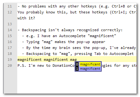

[3.] Backspacing isn't always recognized correctly
  - e.g. I have an Autocomplete "magnificent"
  - Typing "mag" makes the pop-up appear
  - By the time my brain sees the pop-up, I've already erroneously typed "magin" (autocompleting now would result in "maginificent")
  - Backspacing to "mag", pressing Tab to Autocomplete -> Result: "magificent"
[4.] AutoCompletions sometimes disappear and appear twice after re-inserting (see attachments "4-1" and "4-2")
  - While typing the text above, I noticed "magnificent" did not get recognized at alle anymore (it had also disappeared from the AutoCompletions list in Auspex; didn't show up after pressing Refresh).
  - So I made Auspex re-insert it by typing it a few times in a row. Now it gets recognized again, but the popup shows the same word twice.
  - Unfortunately, I haven't figured out how to reproduce this.

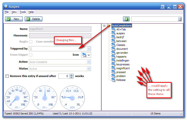

Low-priority feature request: When I select a folder in Auspex, the left pane becomes non-editable. It would be nice if I could make changes to this pane and the changes would be applied to all underlying items (see attachment "5-1").
  - E.g. changing the "Triggered by"-key for the folder "AutoCompletions" would apply the selected key to all AutoComplete-items.
  - It would be nice if the selected "Triggered by"-key would also be applied automatically to newly recognized autocompletions (for autocomplete, I like Enter better than Tab).
