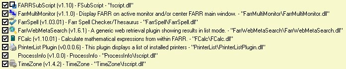

I've been trying to drop plug-in items from FARR one at a time.
I had fscript2 working with just 1 plug-in (TimeZone - thanks Perry) but then FARR threw an error as soon as I tried to look at the plug-ins list.
Thanks, I've found that I've outdated plugins, may be this is why I can't reproduce this issue. I'll try to find the exact same version. Which version of FARR do you have btw, if I have the exact same setup I should get it dammit ;) ?
