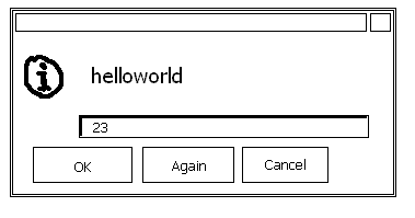

As long as we're already doing this, and I'll be donating to either the site or the coder, why not kick it up a notch? :)
I was thinking maybe adding an editable textfield inside the msgbox or window where this random line would appear. to make it easier to change the probability of it appearing next time...
Let me know if you have any suggestions. i by the way would be using it as a nifty todo list utility, helping me decide what to do next.

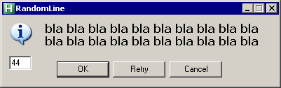

Hey it works. Better than I could ask for actually... ignoring lines without the syntax and everything.
I made a few little changes to the GUI to make it more windows-like.
Just one thing, could you add a little tag before the text, saying the real percentage, in 100% base denominator? So the text would read "[50%] foobar" instead of just "foobar"...
Thank you for this.

Re: A script to display a random line from txt file
« Reply #6 on: February 20, 2006, 10:44 PM »
I didn't quite understand what you meant, but please check if what you're looking for is something like this:
.exe version
.ahk version
« Last Edit: May 02, 2006, 09:46 PM by jgpaiva »

Precisely.
It is complete and working better than expected.
A BIG THANK YOU GOES TO JGPAIVA!
I'll be donating to the site later this week. What a great community.
