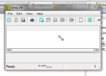

« Reply #158 on: April 10, 2013, 12:51 PM »
hi skwire,
I'm just trying this out today:
on resizing the SnapDB window, I've gotten three freezes so far - with the app hogging one full core (I killed/restarted it in between). I seem to be able to reproduce it by resizing window from the right, but also reproduced it dragging from bottom right (possibly dragging any side will work).
So far I can partially recover by changing the focus to another window and back - but SnapDB continues to hog CPU and doesnt respond properly. (I can drop down a menu but not do any more - if I alttab away/back I can drop down a different menu entry but then it freezes again.)
In the screenshot you can see that the info in the statusbar is garbled from resizing.
Everything else seems to be working okay.
Win 7 64bit
(PS you may have missed the post above mine)
    • Superboy Coder
Re: NANY 2011 Release: Snap DB
« Reply #159 on: April 10, 2013, 03:15 PM »
I can reproduce this by grabbing the right side and shaking the hell out of it but not under normal circumstances.  I'm going to guess the issue is in the Anchor() function that I use for positioning and resizing controls.
« Reply #160 on: April 10, 2013, 05:02 PM »
tha's true, not sure how it happened the first time, but I could only reproduce it by messing around with it :-[ i.e. it's fine in everyday use
