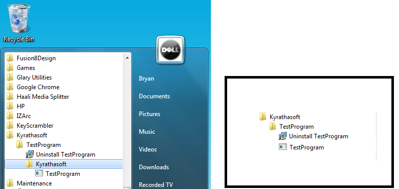

Another question.  The screenshot posted below should help explain.  I want to change the Program Files menu so that instead of looking like it does on the left of the screenshot, it instead looks like what I show on the right.  Can you show me what to change in my *.iss script?

« Reply #6 on: December 20, 2010, 03:12 AM »
Solved it:
[_ISTool]
EnableISX=true
[Setup]
AppName=TestProgram
AppVerName=TestProgram1.0
MinVersion=4.1,4.0
DefaultDirName={pf}\Kyrathasoft
DefaultGroupName=Kyrathasoft
UninstallDisplayIcon={app}\UninstallCharCreator.exe
Compression=lzma
SolidCompression=true
OutputBaseFilename=TestProgramSetup
[Files]
Source: scripts\isxdl\isxdl.dll; Flags: dontcopy
Source: src\TestProgForInnoSetup.exe; DestDir: {app}
[Messages]
WinVersionTooLowError=This application requires Windows NT4, Windows 98 or later.
[Icons]
Name: {group}\TestProgram; Filename: {app}\TestProgForInnoSetup.exe
Name: {group}\Uninstall TestProgram; Filename: {uninstallexe}
Name: {userdesktop}\Test Program; Filename: {app}\TestProgForInnoSetup.exe; Tasks: desktopicon
[Tasks]
Name: desktopicon; Description: {cm:CreateDesktopIcon}; GroupDescription: {cm:AdditionalIcons}
« Last Edit: December 20, 2010, 03:14 AM by kyrathaba »

Good idea.  I'll remove it for v0.96 release.
Re: Need help from Inno Setup gurus
« Reply #21 on: December 27, 2010, 09:23 PM »
agree with ATH, using version # in start menus and start menu groups is messy and error prone.
