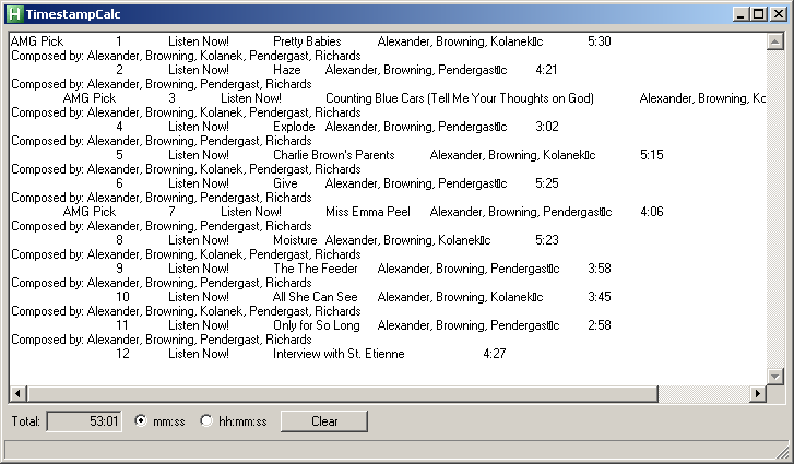

I have this finished.  I made it so it will RegEx match the timestamp out of the line automatically.  In other words, you can simply paste in the AllMusic block of text and it will spit out the total without you having to format the data at all.  My RegEx strings will match the following timestamp formats:
  • x:xx:xx
  • xx:xx:xx
  • x:xx
  • xx:xx
One caveat is that the I only match the first timestamp occurrence in a line.  So, if a line contains two timestamps, only the first one is matched.  Here's a screenshot showing a direct paste from an AllMusic page:
http://skwire.dcmembers.com/apps/snacks/HarvestTime.zip

For the time being, I just left it as TimestampCalc.  Renamed to Harvest Time.  Here's the download:
« Last Edit: December 19, 2010, 04:34 PM by skwire »

« Reply #9 on: December 08, 2010, 09:25 PM »
Thanks skwire.  I'll try it out right away.
Harvest Time sounds cool to me too.
@Renegade feel free to post your take when you have time(no pun intended.) I like to have more than one tool for a job.
edit: skwire this is perfect!! About as easy as it could be!!  Thanks. :)
