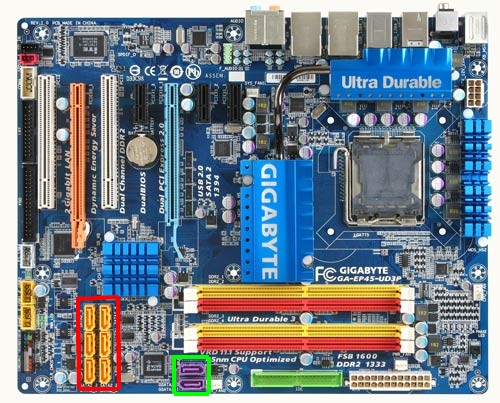

Referring to the picture of your motherboard above:
1) If your system drive is connected to one of the SATA ports in the RED outline, connect it to one of the ports in the GREEN outline instead.  (If both are in use, leave the DVD connected to one and temporary unplug whatever other device is connected.)

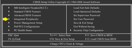

2) Turn the computer on and press DEL to get into the BIOS.
At the BIOS Main page, use the cursor keys to go to Integrated Peripherals and press Enter.

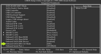

On the Integrated Peripherals page, use the cursor keys to go to Onboard SATA/IDE Ctrl Mode and change it to IDE if it isn't already.
Then hit F10 followed by Enter to accept the changes and reboot.
If the system fails to boot saying it can't find a System Disk, (or just doesn't boot), reboot and press F12 to get to the Boot Menu - you can then choose which drive to boot off and it should boot normally.

So, here's how I have the drives plugged in right now.  I have all the drives (including the system drive) plugged into the yellow slots.  That's 5 drives.  The system drive, two extra internal drives, and two external drives.  Then, I have the SATA dvd drive plugged into one of the purple slots.
If I understand you correctly, you are saying to take my SYSTEM drive off of the yellow plug and put it on the purple plug, along with the DVD drive.  Is that correct?

Gigabyte boards give you these two SATA ports where you can set a different mode on, (the purple ones), so what you can do is:
a) Set the purple ones to IDE Mode
b) Set the yellow ones to AHCI Mode
c) Put the system drive on the purple ports
