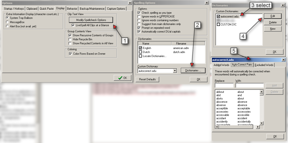

#2:

clarification re (2):
yes, i understand "where" things/settings concerning ther spellcheck dictionaries have to be done, but here is my problem:
i have installed 2 additional dictionaries (ah, the beauty of doing spellchecks in several languages without having to switch!!) and CHS has automatically created a custom dictionary "chris.adu". for "experimental" purposes i tried "adding" specific spellchecks...which are integrated into "chris.adu"...and now i wish to "clean up" this file...question: i observe that if i _delete_  it, the program does not seem to recreate a fresh "chris.adu"...how do i therefore erase entries made into it? or, alternatively: how do i myself create a new ("empty") "chris.adu"?
