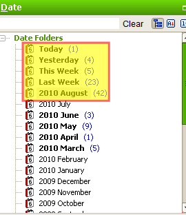

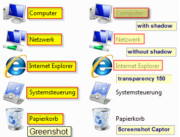

Hi there,
I have the following that's disturbing me:
When I use the Highlighting rectangle, it places a box over the screenshot.
You can perfectly set the transparency, but it fades out the text underneath it.
Maybe you need to split it up in 2 parts:
- highlight a part of the screenshot. (blending mode = overlay)
- cover a part of the screenshot. (blaning mode : normal)
The only difference between both modes are the blending of the object.
And for highlight, it actually needs to fill the lighter pixels with the highlight color, not all pixels.
IF you know photoshop, you know you can change the blending modes between layers.
here are quick details: http://www.freetimefoto.com/photoshop_blending_mode
Hope I am clear enough.
In attachment i've added a screenshot from SSC end one from Snagit (that I used to use :p )
So you see the difference it makes.

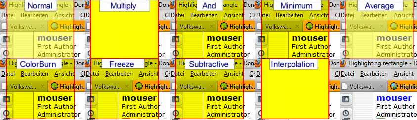

« Reply #19 on: September 06, 2011, 12:30 PM »
Hi Mouser,
thank you for this really great feature!
I've compared the blend methods, and I think "normal" and "average" give the same results.
Also "and", "minimum", "colorburn" and "subtractive" give the same results.
I've not tested all colorcombination and this may differ with the transparency, but I think the methods can be reduced to 4 methods with different results "normal", "multiply", "and" and "freeze".
My favorite is "freeze".
Edit: the example is with no tranparency (=255)
Ralf
Re: Highlighting rectangle
« Reply #20 on: September 06, 2011, 01:51 PM »
Thanks for the chart ralfs!
ps you might want to upload screenshots in .png format in the future as the jpg image is a bit lossy.
