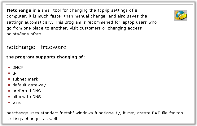

i don't this a lot but when i have to, i use this program: Netchange. :up:
