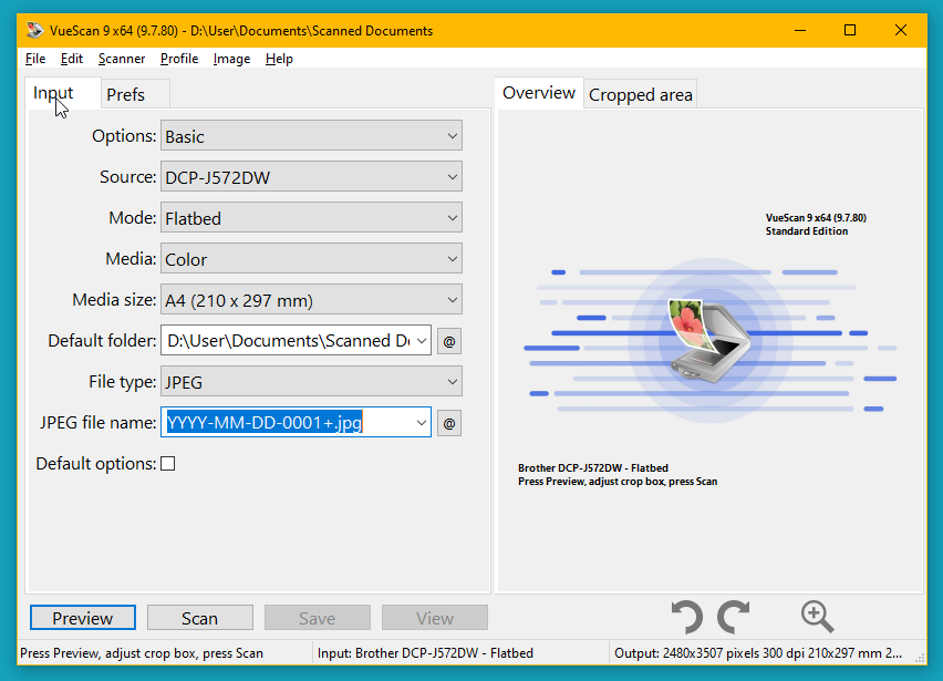

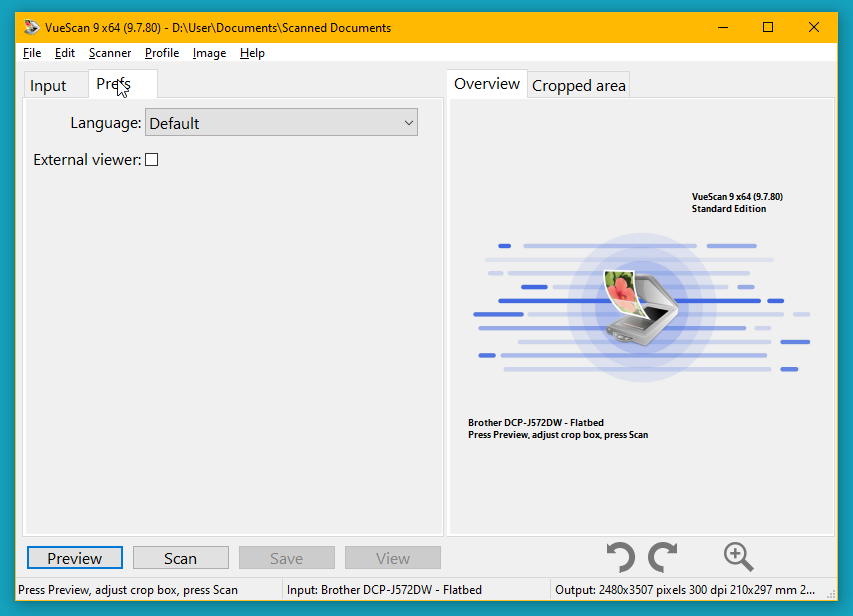

In this post I was originally complaining about the lack of options on the Standard VueScan:
if you look at the first screenshot, you can see that you have to manually change it from basic settings to standard (or pro). I've never seen this on software before so I somehow glazed over it. I also didnt notice this during the short trial and reluctantly bought the software to get a scanner working.
FWIW I still dont see any option to modify compression of saved file (it's fairly high). But otherwise I'm happier now than I was.
PS I dont recommend ticking the Dark Mode option -- this gets turned on for all of Windows!

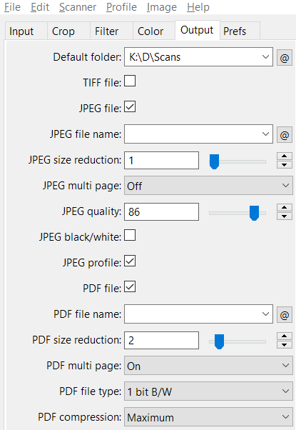

I don"t know about the standard version, but in the professional version there are several options that modify the file size on the output tab:
F.e.:
JPG/TIFF/PDF size reduction
JPG quality
PDF compression
PDF file type
Regards, Brahman
is fair enough imo -- if you want serious quality and control you're going to go for the pro version.
There probably is a workaround if you do need a very high quality scan in the Standard version: scan as Tiff. Compression of Tiff files is AFAIK non-destructive, can then be edited & saved as filetype of choice.
