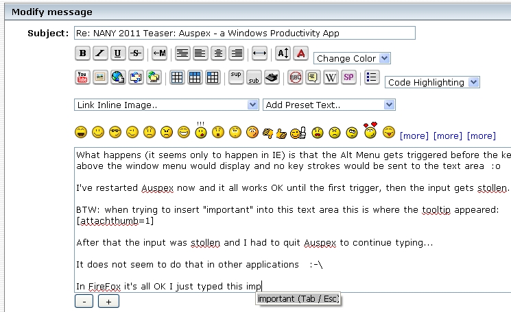

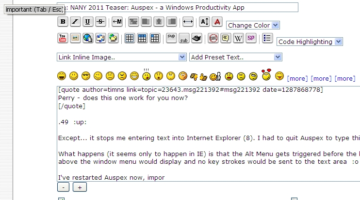

Except... it stops me entering text into Internet Explorer (8). I had to quit Auspex to type this.
What happens (it seems only to happen in IE) is that the Alt Menu gets triggered before the key strokes. So when I was trying to delete some of the above the window menu would display and no key strokes would be sent to the text area  :o
I've restarted Auspex now and it all works OK until the first trigger, then the input gets stollen...
BTW: when trying to insert "important" into this text area this is where the tooltip appeared:
After that the input was stollen and I had to quit Auspex to continue typing...
It does not seem to do that in other applications   :-\
In FireFox it's all OK I just typed this important bit in FireFox:
... and the menus are not stolen  :Thmbsup: (IE... who'd use it  >:( ... but lots of people do...)

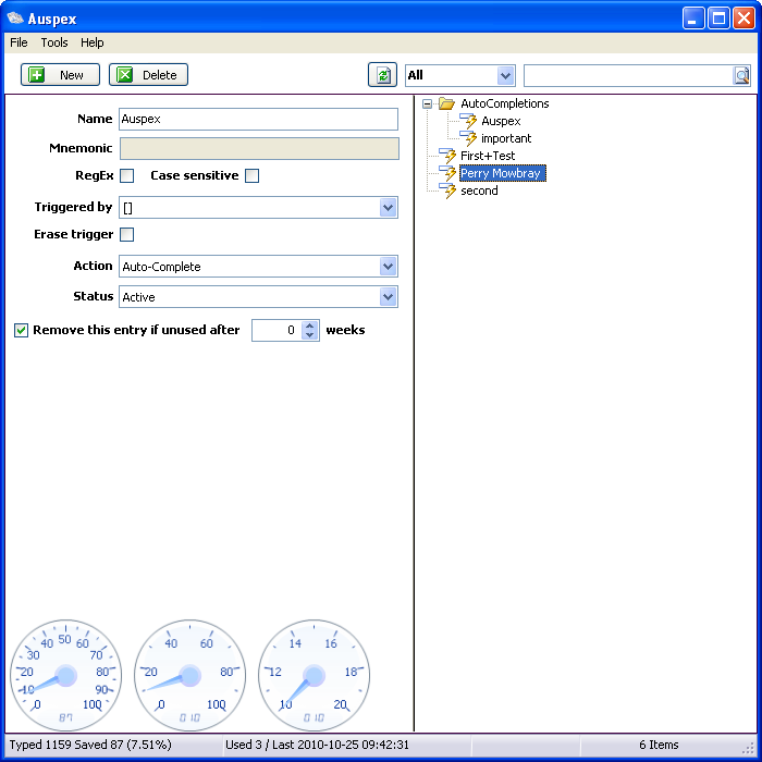

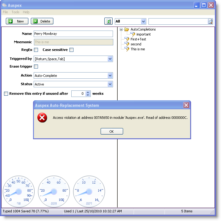

One other little thing...
When changing the Name I got this error:
Then (not sure if it was always like this??) but the "Remove this Entry" tick box does not change per entry:
And note the entry: It says "Auspex" but it's "Perry Mowbray" in the tree...

Thanks Perry. I think the acc vio is now fixed, but I'll do a bit more testing before a new version... and I believe the weird naming in the tree is related, so all being well that'll be gone next time round.
I'll look into the IE thing. I must confess I don't use it and it's all too easy to forget that it's still by far the majority browser.
