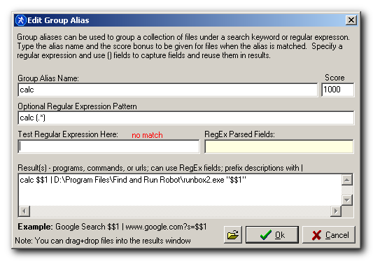

which you can configure this way for farr:

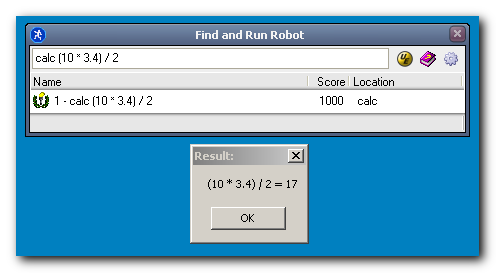

With results like this:
nice!!!!

and needless to say you need to change the filename and path to point to wherever you put your exe.

I love this program!
It does exactly what i was needing, and the "copy to clipboard" feature is extremelly handy, thanks mouser for remembering it :D
