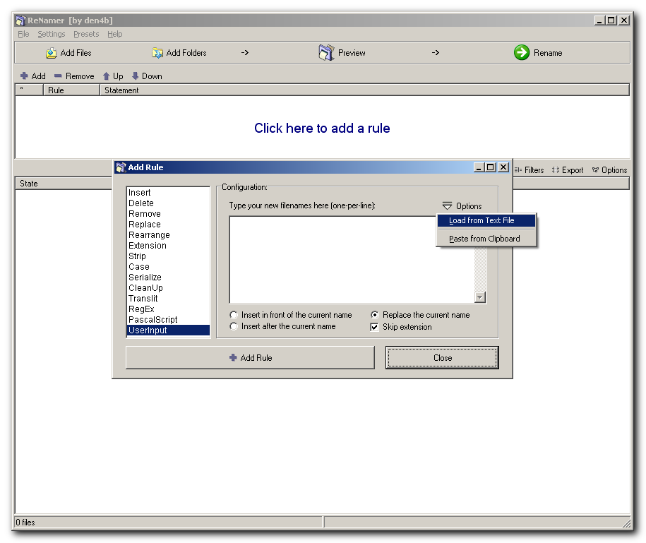

Actually, my favourite file renamer, ReNamer, can already do what you want.  http://www.den4b.com/projects.php
Let me know if that doesn't cover your needs and I'll see about writing something custom for you.
Please note that the list of "right" names have to be in the same order as the files to rename are listed in e.g. ReNamer.
Otherwise you get files with the right names but not the content the names may suggest.
Greetings, Stefan.
Understood.  That's why I offered to write a custom app to be able to do what he wants.  However, most any decent text editor has keyboard shortcuts to move lines up and down so it should be a simple matter for Jabberwock to manipulate his text listing before pasting it into ReNamer.
ReNamer is my favorite too :)
FWIW, I sometimes sort before pasting into ReNamer and tend to sort with an editor.  I haven't tried with Notepad++, but I noticed that TextFX -> TextFX Tools has some line-sorting-related menu items.
