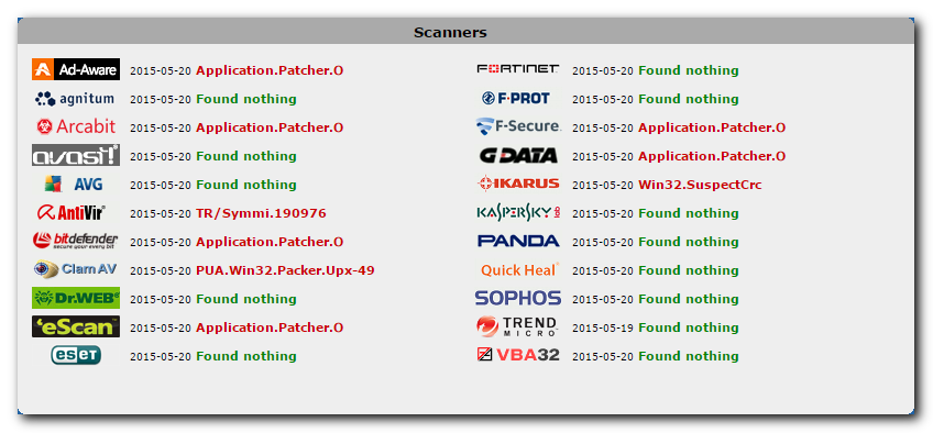

It should be noted that that particular thread is for Windows XP. I'm not sure how/if it relates to Windows Vista/7/8/10, or if the patcher would work on anything newer than XP.
As for the patcher itself:
http://virusscan.jotti.org/en/scanresult/f7e7c18a2b76370d0d225ac78d246660b7516c20

Watching this with interest but a bit scared to try, given the above (false?) positives

I'd be wary about trying to blindly fix an apparent non-critical problem in the MS OS (Systray) by using a third-party "fixer" tool, and without first establishing the likely cause and examining the possible workarounds suggested by MS or in MS forums.
Probably best to err on the side of caution...

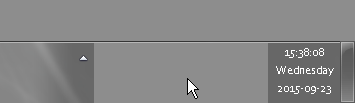

« Reply #82 on: September 23, 2015, 02:01 PM »
Look at *my* tray :D ... :( :(
Possibly related:
I did a bunch of Windows (7) security updates yesterday.
Rebooted fine.
I restarted explorer.exe later (via Process Explorer), tbh, I cant remember why :-[
Later, Windows would not close down - I had to force a reboot.
Today, the tray was fine initially and I havent been doing any funny business...
PS the popup with hidden icons shows as expected

« Reply #83 on: September 23, 2015, 02:44 PM »
[attachment 1 not found]
Possibly related:
Rebooted fine.
Any time you run Windows Update, just about anything can happen.  That is why I disable it.  Of course on the Windows support forums that is an unpopular bit of advice since MS needs to push out the updates to plug the security holes etc..
Other than going through the updates one by one to see if one is bad all I can suggest is open the tray option popup thingie and first uncheck the box that says "show all icons and notifications."  Then set each individual one to show both icons and notifications.  Then check the box again to always show all icons and notifications.  As a last resort you can try flushing the notification cache.  CCleaner has an option to do it I believe.
If all else fails if your system is good with restore points and you have one from just before the updates, you could try going back to then.
