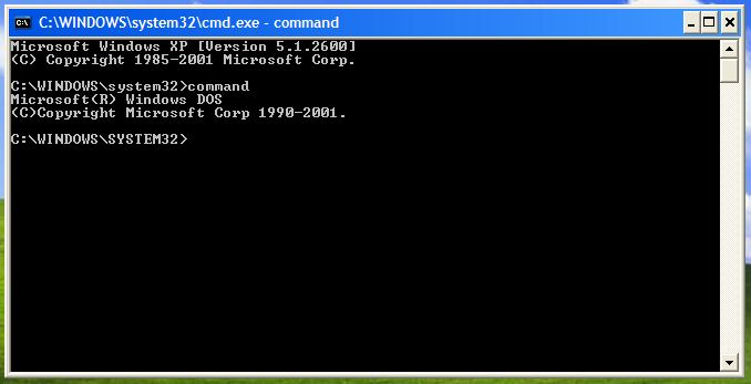

One thing, though: while the console-mode CMD.EXE shell has nothing to do with DOS, except for sharing some of the same commands, 32bit versions of NT did also include 16bit command.com (and a bunch of the other dos tools, although some are 32bit console apps and some are 16bit dos apps) - up to and including XP (don't have any 32bit Vista or Win7 lying around). Difference is that cmd.exe is a native 32bit (or 64bit, in case of 64bit windows) console mode application, whereas command.com is the clunky, junky old realmode 16bit crud running under emulation - and it shows, sluggishness and all. 64bit Windows has no 16bit emulation, so no more command.com :)
Re: Can i upgrade to MS-DOS v6 or v6.22
« Reply #22 on: June 08, 2010, 02:48 PM »
:huh: I don't have a NT4 vm handy here at the office, but command.com in Win2k/XP?!? Where? I've seen (and frequently used) Edit.com in 2k & XP - But I ain't never seen a command.com.
« Reply #23 on: June 08, 2010, 03:35 PM »
He's right. It's in my XP.
Screenshot:

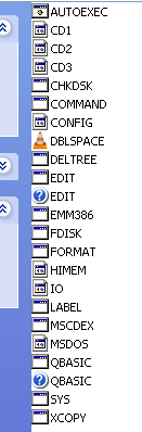

« Reply #24 on: June 08, 2010, 04:07 PM »
...Well I'll be Damned!
...Must be part of the bootable DOS floppy feature. *Shrug*
..And it is still there in (32bit) Win7 also (never thought to look before).
