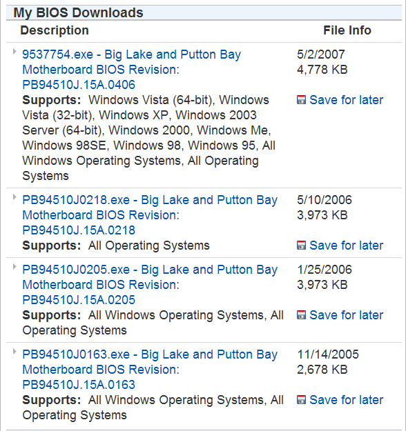

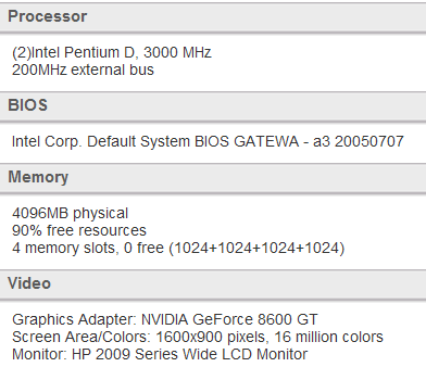

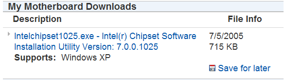

Here's what I'm looking at from gateway support.
Which doesn't seem updated enough.
This is after input of my computer serial number,
and scanning current configuration, with available downloads.
So these are for this Computer.

Your current BIOS seems to have been superseded by 4 versions. Try the top one (5/2/2007) which is designed to add support for Vista (and by implication it is the one most likely to be best with Windows 7).
Windows 7 should install the correct drivers for the motherboard automatically but it cannot hurt to download the latest versions and have them ready. The motherboard driver listed there is ancient - try using something like Speccy or SIW to correctly identify the motherboard and look on the chipmaker's website for the most recent version with Windows Vista/7 support (from the images above it looks like it is an Intel chipset).
Speccy: http://www.piriform.com/speccy/builds (use the portable version)
SIW: http://www.gtopala.com/siw-download.html (go for the free version without installer)
Once you have found out which chipset you can look for a driver here:
http://downloadcenter.intel.com/Default.aspx?lang=eng
« Last Edit: June 21, 2010, 07:36 PM by Carol Haynes »

Bios update worked! Easier then I thought, thanks.
It actually flashed it twice cause it was so old,
and stated that may happen in the instructions,
which I followed.
