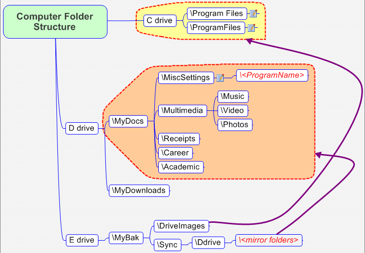

Now, as far as doing incremental updates, that's a somewhat different story.  SFFS can do incremental backups.  Of course, setting it up is more complicated than just mirroring files.  But it's capable of doing it, and since SFFS is such a fantastic program, you know it will do it well.
Personally, I also use Genie backup Manager in addition to SFFS.  While SFFS backs up ALL my files (mirroring on multiple drives), Genie does an incremental backup on just my documents (like Word files, presentations, homework, etc....but NOT large files like videos, music, installers, etc.).  Also, SFFS backs up the Genie incremental backups.
As you can see, there are multiple things going on.  In case you haven't read it yet, you should read mouser's very detailed article on how to backup and the importance of it:

And finally, a while back, I created a flowchart showing my backup philosophy.  I created this based on a discussion with mouser (see the original post here):
