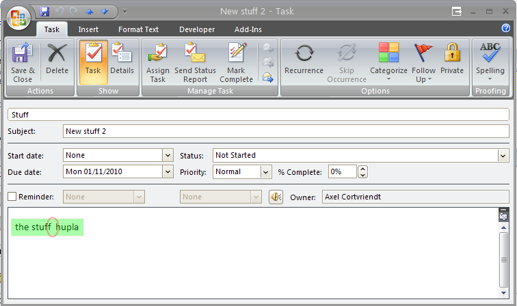

One thing I've seen is that ':' (colon) is removed from the body.
EX.: @Stuff New stuff 2 #01/11/2010 the stuff : hupla
See attachment for result.
Oh, and the site gives me an error :'(
The colon is removed by design, it is just a trigger to indicate that the word that follows is part of the body. Just like the # is removed from the due date. The first part of the body is "the stuff" and the second part is " hupla".
Notice that if you use the colon in normal English* way, without a precediing space (afaik in other languages, too), the colon is not treated specially. So for example, you can say
@Stuff New stuff 2 #01/11/2010 the stuff: hupla
and TaskDaddy will do the right thing and make "the stuff: hupla" the body including the colon.
And as you probably know, the stuff is considered part of the body on the basis that the due date ends the task subject.

Is this good enough or are you requesting it to be interpreted differently?

Personally I had in mind that while the body can be determined after the due date, it wouldn't check for a colon in the text and just take it all :-)
It's just that I find the result strange:
You check for a colon to split the title and the body, but you still return the whole part after the due date. And not just the part after the colon.
so if the body would be "hupla", i would understand it.
And you are correct, normally the colon needs to be attached to the previous word, but consider me not normal :p
The way I use it in tasks is not like written in a continuously text. :-)
I use it more as a seperator and I don't like to use ' - '.
But then it would miss the second category here:
@Stuff New stuff 2 #01/11/2010 the stuff @Project_Stuffy : hupla
and the due date here:
@Stuff New stuff 2 @Project_Stuffy the stuff  : hupla #01/11/2010
But I am open to suggestions if you see a way out without requiring the parts of the task to be in a certain order. :)
I had in mind the user may want to specify multiple body fragments, just as the user may want to specify multiple categories. (Multiple due dates don't make sense obviously, probably I didn't check for this. Hmmm)
I need a little time to think about this, because you are raising a point which I had not thought of, which is a good thing.  :up:
Actually there is a general problem to be solved here that I would very much like to solve..how to allow special characters to be non-special without cluttering up the syntax..for example what if I want a subject that starts with #? I thought about allowing something like a backslash..
But who wants to type:
\#This is not a due date just a weird subject @@Test
@Stuff New stuff 2 #01/11/2010 the stuff \: hupla
Yuck.

Perhaps the real problem is twofold:
(1) Problem 1: That the colon was chosen to be a special character. Say for example, I had chosen semicolon to signal the task body instead of colon. Then you would be able to say
@Stuff New stuff 2 #01/11/2010 @the ;stuff : hupla
or, with task body deduction, you could still leave the semicolon out.
@Stuff New stuff 2 #01/11/2010 @the stuff : hupla
The problem is, if I had used a semicolon, it is just as likely that someone out there is using the semicolon the way you are using the colon. And someone is using the ~ character. So the way out of this seems to be to allow the user to specify their own delimiter somehow.
This is an inherent problem with using special characters. Compare for example Quick Outlook Task which uses extensive command line switches instead of special characters. Honestly, in spite of the fact that jpijper is a DonatonCoder member (long absent it seems unfortunately), I never knew this program existed before I started creating TaskDaddy. Note that he advertises it as a "FARR alias" but can be used from the command line without far as well. The problem of special characters will only get worse as features are added to TaskDaddy over time.
(2) Problem 2: Maybe task body deduction itself is a bad decision I made. I don't recall any other program that parses that way.
Maybe I should have simply required the colon to introduce the task body:
@Stuff New stuff 2 #01/11/2010 @the :stuff : hupla
For this to work, I think I would still have to require all subsequent trigger characters to be ignored, which means I would still have a problem with initial colon meaning trigger sometimes and included as regular text sometimes.
« Last Edit: September 22, 2010, 12:09 PM by daddydave »
