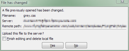

i'm using filezilla - which brings up a dialog asking me if i want to upload edited files that it is monitoring...
the problem is that this dialog hardly ever has focus when it appears - and i can't alt+tab to bring it into focus. okay, i can use the mouse to click the buttons on it but it's annoying as it would be about a million times more convenient to keep my hands on the keyboard.
any idea how to bring a dialog window into focus that doesn't respond to alt+tab?
thanks.
(is this vista being dumb or just me.)

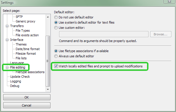

i use filezilla too. where is this option? maybe i can try to get it to appear on my PC.

for the edit monitoring to work you have to open/edit a file from the panel inside FileZilla - otherwise it doesn't know you are editing things.
then you'll get the prompt to appear when you save your opened/edited file.
try changing the "windows id" line to this:
Code
WindowsID=File has changed ahk_class #32770  ; windows title and ahk class goes here. either will do..
that would help, i guess.

you're welcome.. :) just curious why did you put the quote marks?
btw, the title matching mode is set to partial match so any of the word will do.
SetTitleMatchMode 2 ; partial title match
however, with the quote marks, AHK will look for one of these words:
"File
has
changed".
which leaves "has" as the only match.
