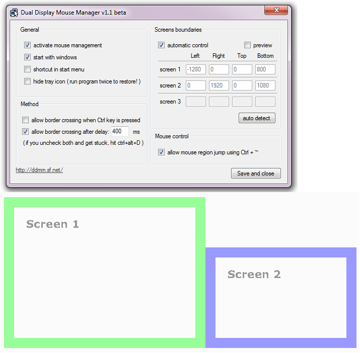

Here's another one... Dual Display Mouse Manager (ddmm)

thanks PhilB66. i'd already tried that one - you (or someone else might have mentioned it elsewhere on the forum).
it doesn't really provide the wrapping option - rather the opposite, in that it will momentarily pause the mouse when it touches the edge of the screen. the hotkey for jumping to another monitor isn't that helpful either.
at the moment MouseWrapper works the best for wrapping.
