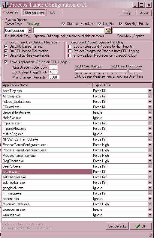

Not sure if this might help, but I thought I should mention it - because I had a similar "problem" with Process Tamer not longer after I started using it, some time ago.
It seemed to be not obeying the rules that I had set up. Then I discovered that PT seems to be sort of "case-sensitive" (or at least ASCII-value sensitive).
One of my pet hates is Acrobat's AcroTray. I had a rule in PT to kill it, but after Adobe Acrobat Reader was updated, AcroTray started up and PT seemed to ignore it. Then I realised that the currently-running version of AcroTray (as shown in Process Explorer) was in a different case to the rule I had previously set up.
The only way I could make sure it got killed was by defining the rule 3 times, thus: (I guess this this covered the common permutations of case in the name)
  A. AcroTray.exe
  B. Acrotray.exe
  C. acrotray.exe
The clue I had to case being somehow involved in this was in the PT alphabetic sort on process name in the PT Configuration GUI. For example, if you look at the screenshot attached, you will see how instance B is below A, and C is half-way down the list below that.
