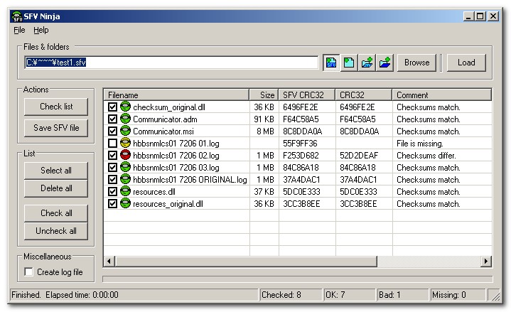

    • Superboy Coder
Re: auto email a list of folder contents - is there a util?
« Reply #7 on: April 04, 2010, 01:13 AM »
Would this be better done with one of the utilities that make CRC or MD5 checksums?
For what it's worth, I've written an SFV app that I've never released.
