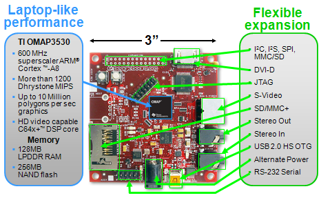

I ordered myself two of these BeagleBoards just recently for a similar purpose to what you're suggesting.

Eoin's example is exactly the direction I was going in until you said you wanted basically a low-power general purpose PC with standard OS. You could run Linux on the BeagleBoard, but not Windows (well, except WinCE), so it may be a bit limiting.
So my vote would probably be for a "tiny PC", probably Atom-based, like f0dder said. That's as long as you really have no need for the portability of a laptop, and particularly if you have interest in more flexibility and customization down the road.

since the device does not have to be placed in a really tiny space, i dont need a really tiny beagleboard type thing; in terms of size, a mini-itx would be fine, as would a laptop.
