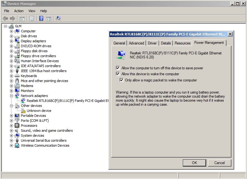

As far as I know Windows XP power save mode shuts down everything on a very low level. It is possible to turn this off (per device) in the Windows device manager.

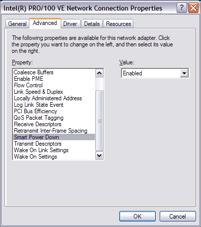

If you have an Intel NIC, try disabling the Smart Power Down (or Deep Smart Power Down) property on the NIC's advanced properties page in Device Manager. I've had several cases where that setting caused the NIC to get disabled once the PC went into any of the low power, suspend, or "on battery"(if it's a laptop) modes.
I'm not sure what websense is doing, but your network may be interpreting your lockdown  as a disconnect after which it tombstones your DHCP-assigned address and drops your network credentials because it thinks you're gone. That could explain why you need to re-log to get back on.
