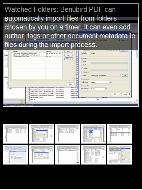

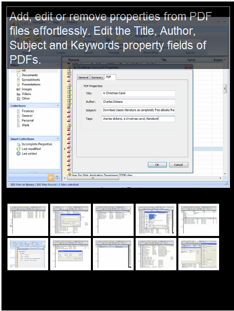

I haven't looked at Benubird since moving to W7, but take a look at these screenshots. One of them says you can edit the data you speak of. I would copy some pdfs to a new folder to test it's abilities.

A little more info.
When it imports files with extensions of your choosing, it leaves the original where it was.
That was a concern of mine when starting out with BB.
Here's the screenshots I was talking about.
In the forums of BB, keeping existing tag, meta, and exif data is discussed.
« Last Edit: March 14, 2010, 01:26 PM by cmpm »
