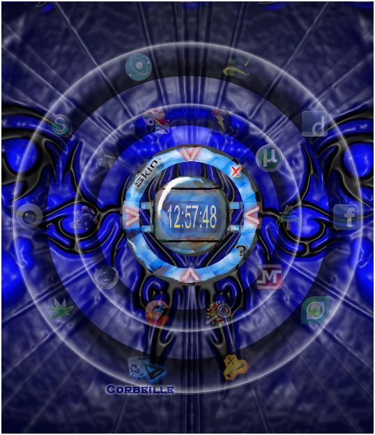

I thought the middle of your circle was a software clock like mine.
Me in the middle of my circle is the software clock with many skin
(Look at my examples, you can really put the theme you want)
The software I use to the center of my circle are
- Custom Skin Clock
- HorloMillvisio3
Thank you very much for your understanding and for your help, hoping that these few examples of ring you like
You can tell me what you think it'd be nice ...
