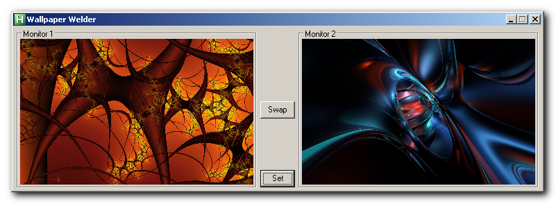

Here is one of the crudest proof-of-concepts I've ever released.  Currently, there are NO options to do anything to your chosen images (stretch, center, etc).  So, for the best results, pick two images that match the resolution of one of your monitors.  For instance, I have two 1680x1050 screens so I'd choose two different images whose dimensions are each 1680x1050.
Usage:
  • 1) Simply drag and drop an image to each box and click the "Set" button.
  • 2) If the images didn't end up on the monitor you expected them to, click the "Swap" button and then click "Set" once more.
Caveats:
  • 1) Currently, this application is intended for dual-monitor setups where the monitors are the same resolution and side-by-side.
  • 2) WinXP and later; no Win9x support.  You should be able to use this under Win2k if you have the gdiplus.dll installed.
Again, this is a proof-of-concept and, at this point, I'm not even certain I want to continue making this into a full-fledged application.
Download:  http://skwire.dcmembers.com/apps/snacks/WallpaperWelder.zip
All that said, I'd be curious to know if it works on anything besides my home and work computers.  =]
« Last Edit: February 17, 2010, 03:17 AM by skwire »
FrankEBailey`
  • I am a maniac
  • Posts: 20
Wow, that was fast :)
Unfortunately when I run it under Windows 7 Ultimate x64 it does.... Absolutely nothing.  :o
I can drag the pics to the squares, and they swap around alright, but clicking "set" does nothing at all.
Just my 2c. Even if you don't choose to proceed further with it, thanks for trying.  :Thmbsup:
    • Superboy Coder
I don't have Windows 7 so I have no way of testing it.  At this point, I'd have to guess that Microsoft have changed something with the way wallpapers are set between XP and Windows 7.
I can sort of confirm the nothing happens (I'm on Win7 x64 pro). I didn't have any pics with the same resolution as the desktop, but I gave it a shot with a different size and it tiled the existing wallpaper into blocks the size of the image I'd selected.
(Correction/clarification-> It didn't change the size of the currently displayed wallpaper, it only tiled it at its native size (it had been stretched to fit).
« Last Edit: February 17, 2010, 12:32 AM by Stoic Joker »
    • Superboy Coder
Hmmm...that would indicate that it DID try to set the wallpaper.    :huh:
i tested on win7 and it seemed to work, so that's strange that it's working for some people and not others..
