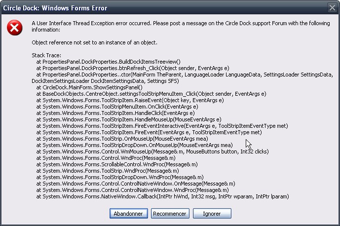

When CD opens and I click on Settings in the context menu CD crashes and I get this error message (which of course I can't make head or tail of) and I have to kill the process.
Gone back to previous for now  :(

I am curious to know why you clicked on the "Refresh" button on the Dock Items tab of the Inspector. For you to be able to do that, the Settings dialog loaded correctly so the problem lies elsewhere.
Please use the Problem Report tab of the Inspector to file an incident report: I need further information about you current configuration and that will give it to me.

Markham I didn't click on the "Refresh" button on the Dock Items tab of the Inspector - I simply clicked once on the Dock Settings item in the context menu. When I do this a giant bluish bar appears with "loading settings" across it and then the error message is shown.
I can't go further than this so I can't use the Problem Report tab of the Inspector...!

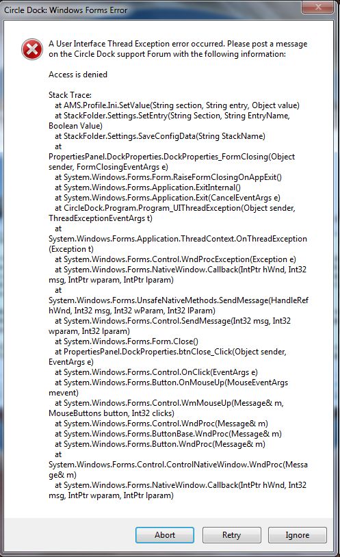

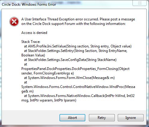

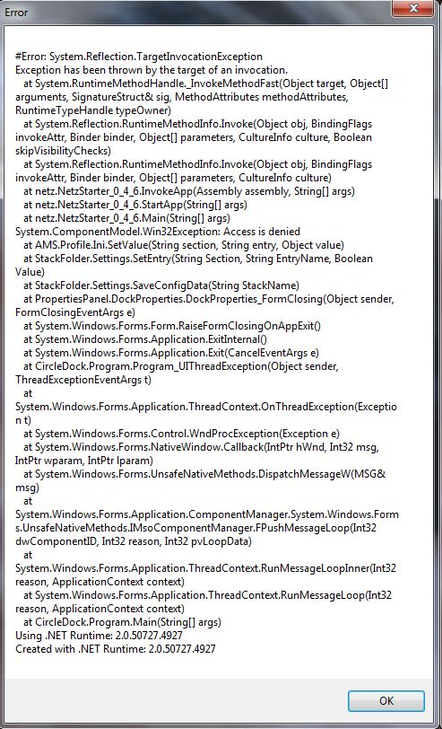

I have a similar but different crash to that decribed by joiwind with v1.523 and now v1.53. Version 1.0 did not have this problem. In my case with CD open every time I click on Dock Settings in the context menu and exit (not when it opens) CD crashes and I get a sequence of three error messages (which I too can't make head or tail of), one after the other on clicking Abort or Retry and I kill the process.
[attach1]
[attach2]
[attach3]
I am running CD on Windows 7 64-bit, am not getting any mis-behaviour on anything else, and otherwise CD works brilliantly (with just a couple of minor niggles that I will write about separately).
Any help or advice will be greatly appreciated.
Thanks.

Sorry, something went wrong with first two error message attachments.
[attach1]
[attach2]
Thanks again.
Actually your issue occurs when you close the Folder Stack Properties dialog. Circle Dock is unable to write to a configuration file as it is protected by User-Access Control (UAC). You'll need to reduce the UAC setting so that it allows this operation or, in extremis, turn-off UAC completely.
Mark
NigelRBrown
  • Posts: 6
Re: v 1.5 problems - freezes and crashes
« Reply #13 on: February 12, 2010, 11:03 AM »
Thanks Mark. Actually I have cured the problem by running CD as Administrator. It does the trick for Dock Properties and CD generally seems more stable.
