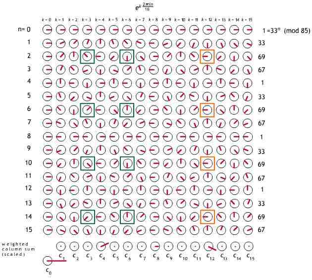

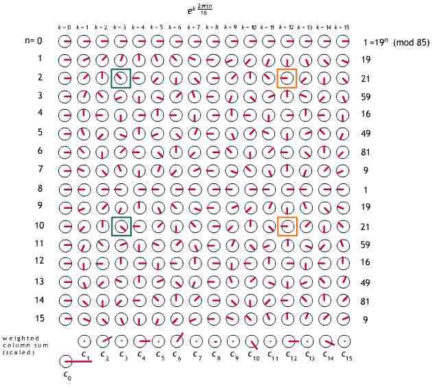

Fig. 1. Discrete Fourier Transform analysis of the sequence given by the first 16 powers of 19 (modulo 85), a sequence with period 8 and frequency 16/8 = 2. When n is a multiple of 2 (e.g. orange boxes) every re-occurrence of a sequence item gets the same coefficient, and cn has a chance of being nonzero. Otherwise (e.g. green boxes) it is zero. The complex numbers in the matrix are graphically represented as unit vectors. Each cn is the weighted vector sum of the entries in the column above it, weights coming from the fk column on the right, with an overall factor of 1/2A = 1/4. The cn have been uniformly scaled to fit in the picture.
Fig. 2. Discrete Fourier Transform analysis of the sequence given by the first 16 powers of 33 (modulo 85). This sequence has period 4 and frequency 16/4=4. The non-zero cn only occur for n a multiple of 4. Graphic conventions are the same as in Fig. 1.
Why powers of 2?
I have chosen for illustration a number (85) which generates power residue sequences with periods which are powers of 2, and I have chosen to analyze a length (16) of sequence which is also a power of 2. The second choice is not immaterial: The Fast Fourier Transform we will use, and its quantum adaptation, both require it. The first choice is only for covenience in generating a small example. Shor shows that to get a reliable read on the power residue period in general, in the problem of factoring N, one must analyze sequences of a length 2n between N2 and 2N2. So to analyze a number like 85 realistically, we would have to work with sequences of length 8192.

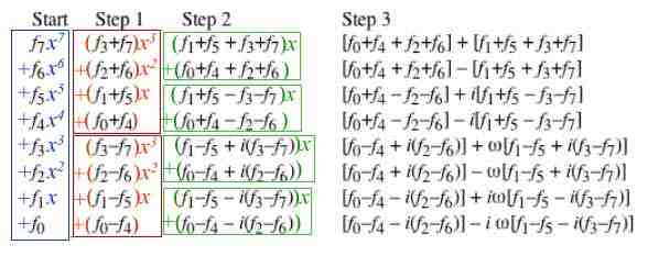

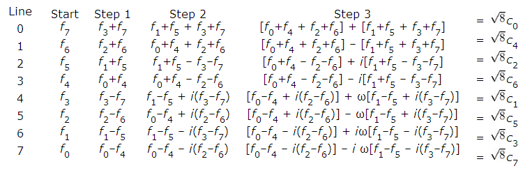

Our Fast Fourier Transform leads in n steps from the elements f0, ... f2n–1 of the input sequence to the coefficients c0, ... c2n–1 of its Discrete Fourier Transform. We illustrate the process here for n = 3. Each column represents a successive step of the calculation.
Notes:
In this presentation of the algorithm the elements of the sequence f are ordered backwards and the elements of the transformed sequence c appear in "bit reversed" order: cn appears on line k where (in binary) k is n written backwards; e.g. c6 (110) appears on line 3 (011).
Working with a sequence of length 2n the computation table has 2n rows; in each row are n columns requiring computation; each entry is calculated as a linear combination of two entries from the previous column, and so requires two multiplications and a sum; altogether 3n operations per row for a total of 3n2n operations. Contrasting this with the 2n (2n+1 – 1) operations to implement the Discrete Fourier Transform shows that the Fast Fourier Transform is fast indeed.

Returning to the Fast Fourier Transform calculation
we can understand Step 1 as transforming the degree-7 polynomial f into two degree-3 polynomials (red boxes) each of which can produce, via its remainders, half of the cn. Then Step 2 transforms each of the degree-3 polynomials into two degree-1 polynomials (green boxes), each of which can produce a quarter of the cn, and Step 3 transforms each of the degree-1 polynomials into two degree-0 polynomials, which are their own remainders.
